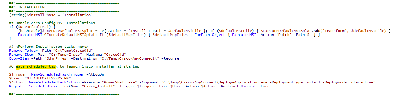

Using PSDK (Powershell deployment toolkit) we added a step to create a scheduled task, after the reboot, the scheduled task is then removed.
The actual deployment
will copy the package down to the machine.  (If there was already a folder named it will rename the folder to "old".)
will create a scheduled task to run at next log on
will remove the task afterwards
