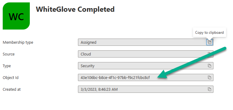

Step 1. Create an Azure AD group
In Microsoft Intune, create an assigned device group called WhiteGlove Completed. This group will dynamically fill with computers that have completed the upload of the BitLocker recovery info in Part 2 based on registry settings via a scheduled task.

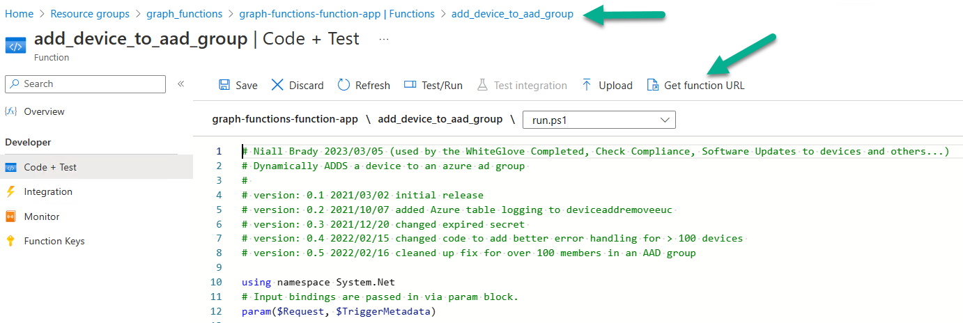

Once done and tested, copy the functions URL in the function app

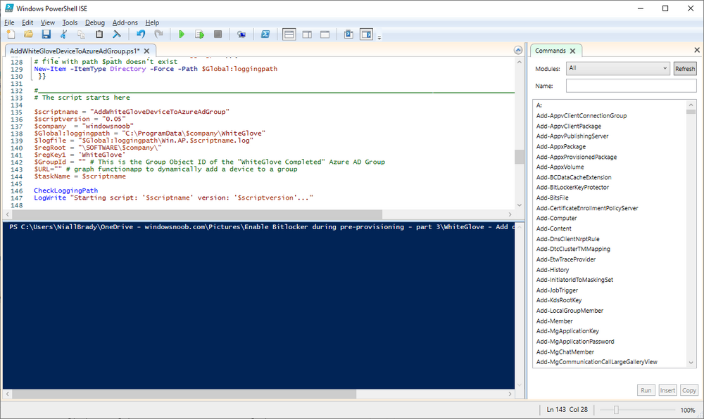

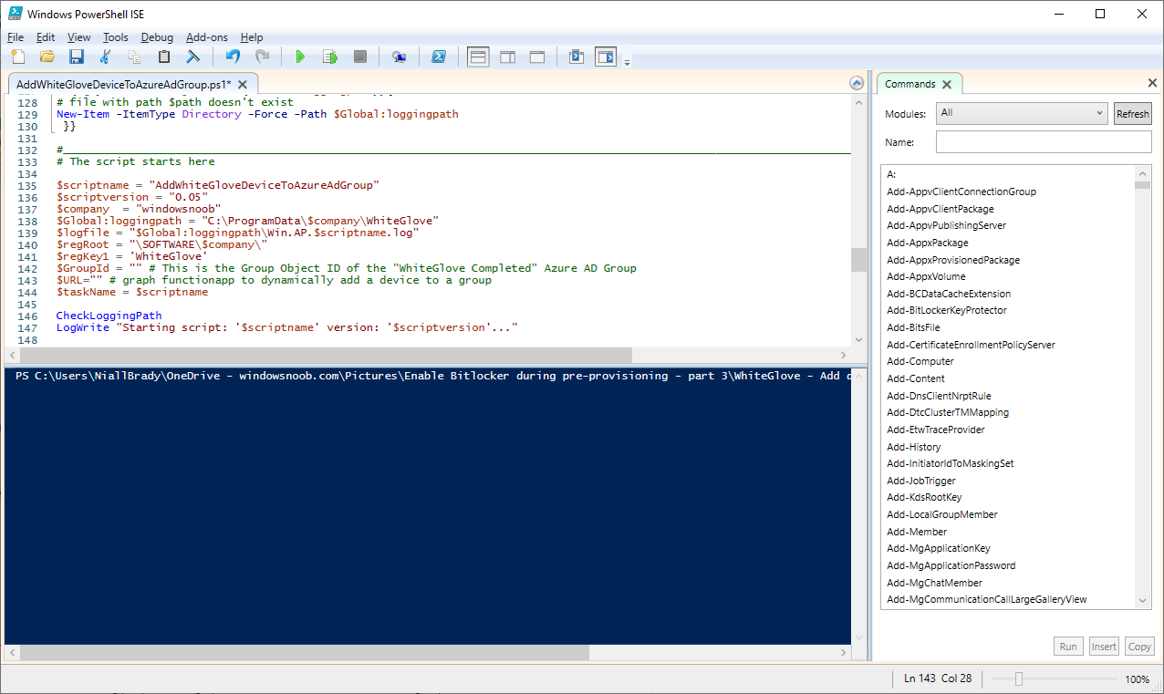

Modify the AddWhiteGloveDeviceToAzureAdGroup.ps1 script and configure the Object ID (of the WhiteGlove Completed group) and the URL of the http trigger for adding devices to an azure ad group. That is lines 142 and 143 in the screenshot below:

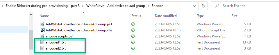

Once done with your changes, you'll need to encode the files to a base64 text file. To do that, modify the path of where you are running the encode script, then run it in PowerShell ISE.
This will leave you with 2 new encoded scripts, shown below

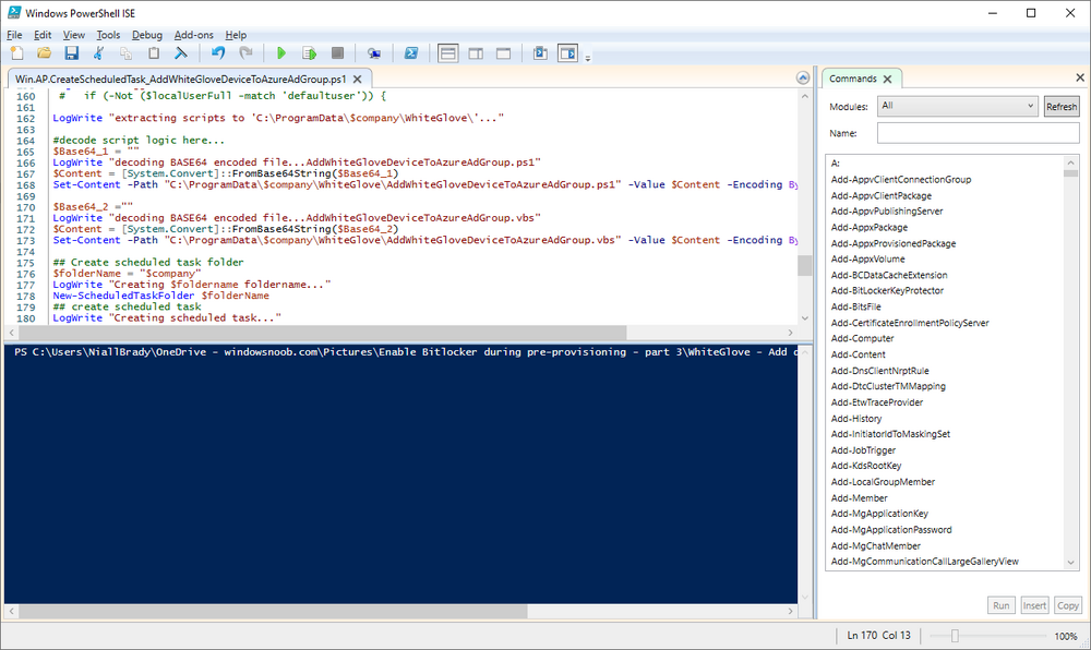

Open each of the respective encoded text files in notepad and mark all text within (CTRL+A) then COPY the text (CTRL+C),
Then paste that copied text into the respective variables in the Win.AP.CreateScheduledTask_AddWhiteGloveDeviceToAzureAdGroup.ps1 script in lines 165 and 170.
save your changes, to the Win.AP.CreateScheduledTask_AddWhiteGloveDeviceToAzureAdGroup.ps1 script

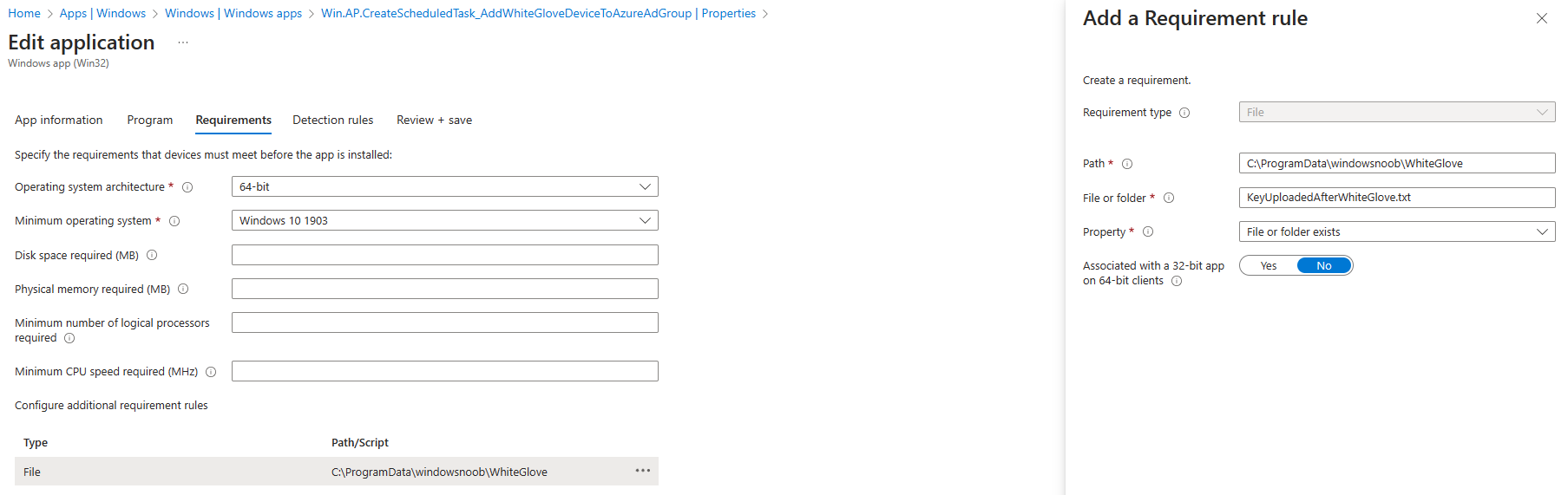

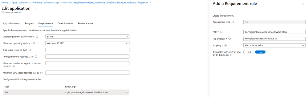

Additional requirement rules
File C:\ProgramData\windowsnoob\WhiteGlove\KeyUploadedAfterWhiteGlove.txt
as per the screenshot below:

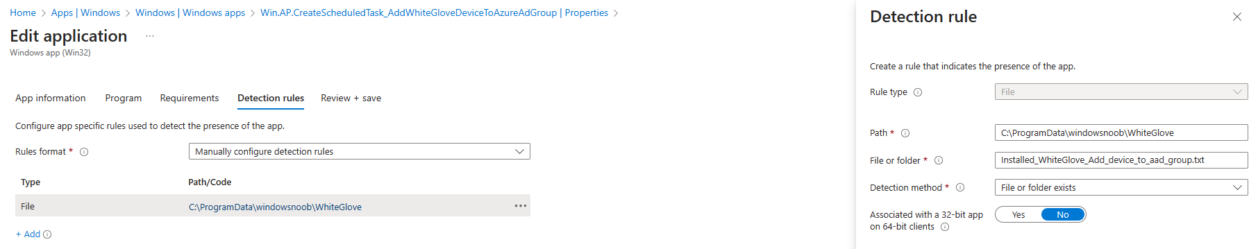

Detection rules
Rules format: Manually configure detection rules
Detection rules File: C:\ProgramData\windowsnoob\WhiteGlove
File or folder: Installed_WhiteGlove_Add_device_to_aad_group.txt
Detection method: File or folder exists

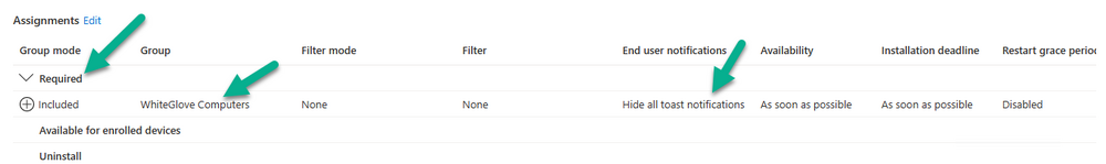

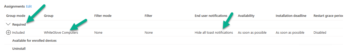

finally, assign the Win32 app as Required to our WhiteGlove Computers Azure ad group created in part 1.

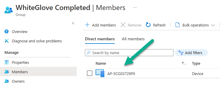

To do that preprovision a WhiteGlove computer, get a user to enroll it, and after it's all complete the device will get magically added to the WhiteGlove Completed Azure AD group via the Win32 app in this part.

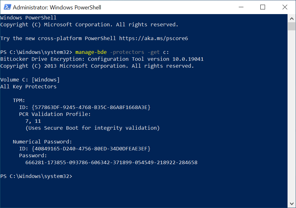

To verify everything is working, take note of the BitLocker recovery info on the device...
Verify it's the same in Intune

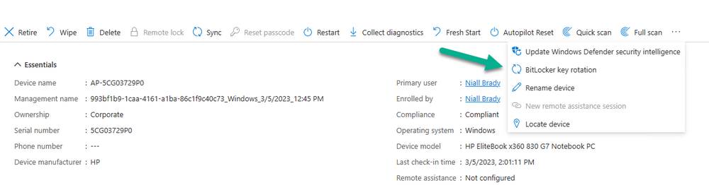

and next, trigger a BitLocker key rotation action in Intune

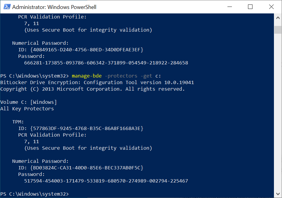

You can then confirm on the device that it's rotated
and the new recovery key information is stored in Azure.

03/05/2023 13:04:28 Device: AP-5CG03729P0 is already in the WhiteGlove Completed group, nothing to do.
03/05/2023 13:04:28 The computer is already in the group, nothing to do.
03/05/2023 13:04:29 Exiting Azure function.
03/05/2023 05:04:29 Group name identified as: 'WhiteGlove Completed'
03/05/2023 05:04:29 The computer was confirmed as added to the group.
03/05/2023 05:04:29 Removing the scheduled task...
03/05/2023 05:04:29 About to delete scheduled task: AddWhiteGloveDeviceToAzureAdGroup
03/05/2023 05:04:31 Succeeded to remove scheduled task: AddWhiteGloveDeviceToAzureAdGroup
03/05/2023 05:04:31 Exiting script.
and the scheduled task creation log file
03/05/2023 05:02:34 Starting the 'Win.AP.CreateScheduledTask_AddWhiteGloveDeviceToAzureAdGroup' version '0.01' script...
03/05/2023 05:02:34 Checking if computer was enrolled within the allowed timeframe...
03/05/2023 05:02:34 Current date/time = 03/05/2023 05:02:34, computer install date/time = 03/05/2023 12:45:48
03/05/2023 05:02:34 Enroll date [03/05/2023 12:45:48] created within the allowed timeframe...
03/05/2023 05:02:34 Hours since enrollment: -7.72057391491667
03/05/2023 05:02:34 EnrollmentDateCheck detected as: True
03/05/2023 05:02:34  Logged on user is: AzureAD\NiallBrady
03/05/2023 05:02:34 extracting scripts to 'C:\ProgramData\windowsnoob\WhiteGlove'...
03/05/2023 05:02:34 decoding BASE64 encoded file...AddWhiteGloveDeviceToAzureAdGroup.ps1
03/05/2023 05:02:34 decoding BASE64 encoded file...AddWhiteGloveDeviceToAzureAdGroup.vbs
03/05/2023 05:02:34 Creating windows-noob foldername...
03/05/2023 05:02:34 Creating scheduled task...
03/05/2023 05:02:36 Info: The scheduled task doesn't exist, will create it.
03/05/2023 05:02:36 DEBUG: Using the following values for the scheduled task...
03/05/2023 05:02:36 DEBUG: Time: 03/04/2023 05:03:36 Script: C:\ProgramData\windowsnoob\WhiteGlove\AddWhiteGloveDeviceToAzureAdGroup.vbs Action: MSFT_TaskExecAction Trigger: MSFT_TaskTimeTrigger Settings: MSFT_TaskSettings3 Principal: MSFT_TaskPrincipal2 Foldername: windows-noob.
03/05/2023 05:02:37 DEBUG: task=MSFT_ScheduledTask (TaskName = "AddWhiteGloveDeviceToAzureAdGroup", TaskPath = "\windows-noob\") taskName=AddWhiteGloveDeviceToAzureAdGroup run=03/05/2023 05:03:36
03/05/2023 05:02:37 DEBUG: settings the scheduled task settings=MSFT_ScheduledTask (TaskName = "AddWhiteGloveDeviceToAzureAdGroup", TaskPath = "\windows-noob\")
03/05/2023 05:02:37 Exiting script.
