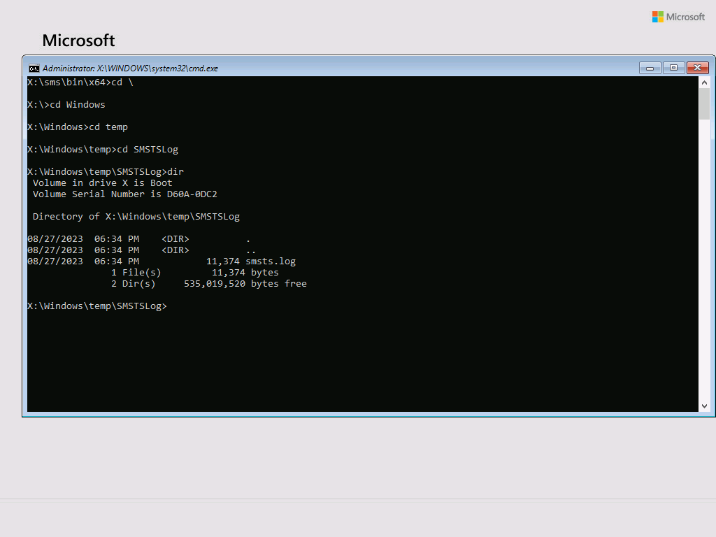

the reason for the reboot is it either can't see a task sequence or missing drivers, but we are not seeing that in this log,
is there anything further logged in smsts.log ?
on the client, press f8 to bring up a cmd prompt, then click on your available task sequence, browse to x:\windows\temp\smstslog and find and download/attach the smsts.log file here please

if you have enabled it on the boot image, then redistribute it to the distribution point(s) and try again
then something is not right, if you enable f8 command support then it should work, if it is not then you are working on the wrong boot image to the one in the console
