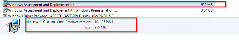

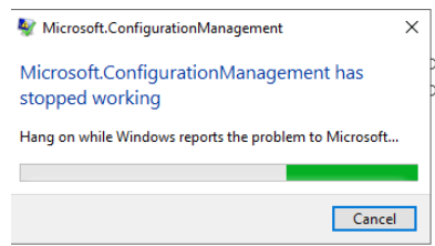

keywan Posted May 15, 2024 Report post Posted May 15, 2024 Hi, Since I upgraded my SCCM to the version 2403, I cannot use any more MDT and UDI. I cannot create a new MDT Task Sequence and all my created MDT Package for UDI does not work too. I could to use UDI for Task sequence in my previous SCCM 2207 and could install Windows with UDI, but since SCCM 2403, I get every time by the step "Use Toolkit Package" the error Task Sequence has failed with the error code 0x00000001 in the task sequence step 'Use Toolkit Package. And I try to create a MDT TS, getting the Error And the Console is away Is it not more supported MDT and UDI by SCCM 2403? Quote Share this post Link to post Share on other sites More sharing options...

keywan Posted May 15, 2024 Report post Posted May 15, 2024 MDT version 6.3.8456.1000 And the ADK version Quote Share this post Link to post Share on other sites More sharing options...

anyweb Posted May 19, 2024 Report post Posted May 19, 2024 ok i see MDT crashing if I choose to create a new MDT task sequence, so yes I have issues after the upgrade too. I also had the console crashing (see my blog here) after the upgrade but after downloading and installing the offline .net 4.8 and restarting the site server the crashing problems went away, so.. do you have .net 4.8 installed ? i've emailed the Product Group to see if they are aware of MDT issues and 2403... Quote Share this post Link to post Share on other sites More sharing options...

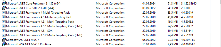

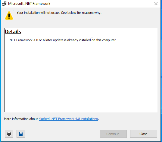

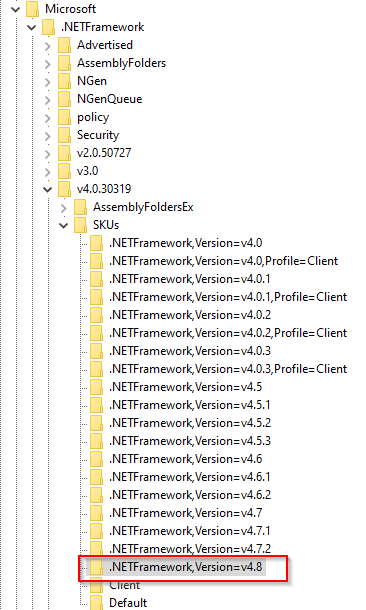

keywan Posted May 21, 2024 Report post Posted May 21, 2024 Hi, Please be sure that my Console does work fine, ONLY if I run by Task Sequence--->Create MDT Task Sequence, then the Console crashed I have the following .Net Version If Try to install the .Net 4.8, getting the message I checked the REG KEY Can I install the .Net 4.8 without any issue for SCCM server? I mean without any effect? Quote Share this post Link to post Share on other sites More sharing options...
anyweb Posted May 21, 2024 Report post Posted May 21, 2024 yes but it won't help the MDT issue, i've informed the Microsoft Product group about this, let's see if they respond. 1 Quote Share this post Link to post Share on other sites More sharing options...
