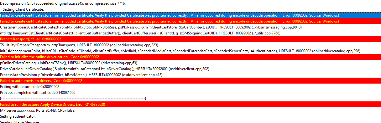

They are failing at applying device drivers with the following error
Failed to create certificate store from encoded certificate. Verify the provided Certificate was provisioned correctly. .
An error occurred during encode or decode operation. (Error: 80092002; Source: Windows)

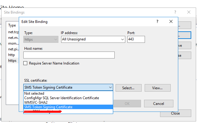

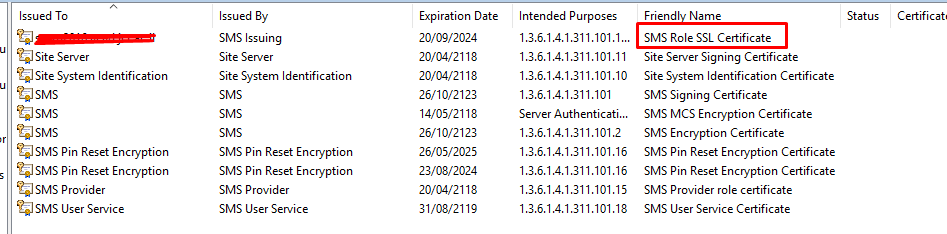

I found that enhanced http is configured on the server
, however even thought the certificate is found in the certlm.msc
, the manager is not importing the certificate to the IIS:
Referring to the difference between USB OSD and CLient Config OSD the certificates only show on the client after the USB OSD and not when using the client.

smsts-m920.log
from you log i saw this line
Quote
and a quick search brought me here https://learn.microsoft.com/en-us/troubleshoot/mem/configmgr/os-deployment/pxe-boot-not-work
can you try the advice there and report back ?

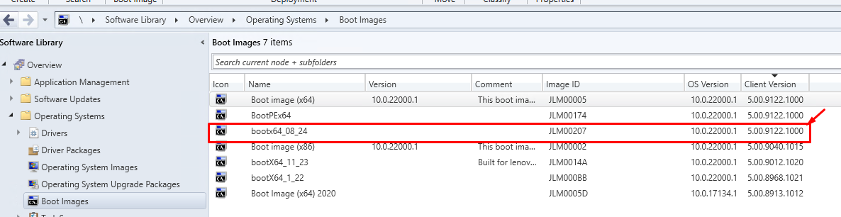

I finally found the solution, i noticed that the boot image was not up2date, with the current client:
i created a new one and now it works.

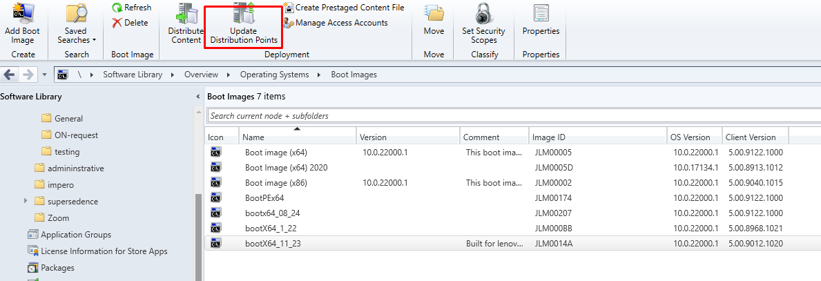

Then i saw you can up date the current boot images by using the update distribution points
