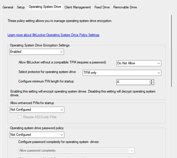

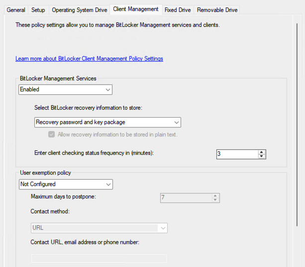

I’ve deployed BitLocker using your setup articles, but I’m encountering an issue where the devices aren’t encrypting the drives as expected. Any assistance you can provide would be greatly appreciated.

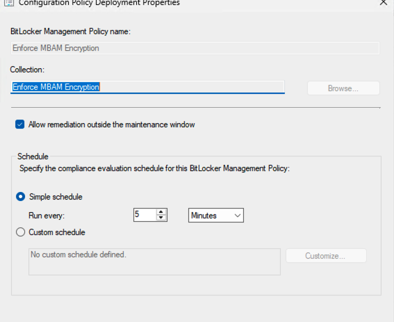

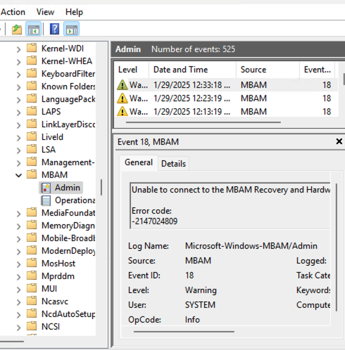

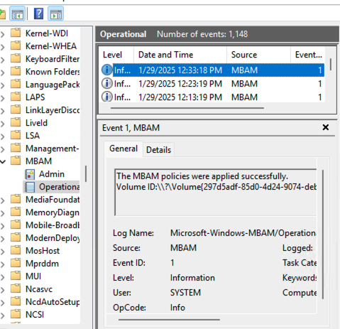

It’s worth mentioning that the devices I’m testing with are all located in the same device collection where the MBAM encryption policy has been deployed. Additionally, all the devices have TPM 2.0, TPM is enabled and ready, and Secure Boot is also enabled. As for the logs, everything appears to be working as expected, except for the MBAM admin logs, which indicate that it cannot connect to the MBAM and hardware recovery services. However, according to Microsoft’s documentation, "Starting in version 2103, the implementation of the recovery service changed. It no longer uses legacy MBAM components, but is still conceptually referred to as the recovery service." Given this, I assume this error log should not affect the encryption process, correct?

I have attached a few screenshots for your reference.

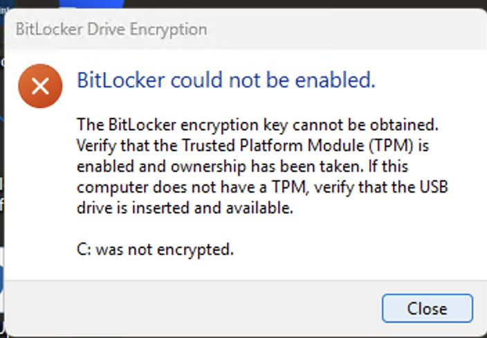

Hi, there is no CD/DCD in the tray, nor is there an ISO mounted on the system. Correct, I initiated a console login through Microsoft RDP to check the encryption process, but I always receive the following error message described below.

Yes, I’ve tried that as well, but I’m still getting the same error message. One thing I didn’t mention earlier is that I’m running this ENV on HTTPS, but as far as I can tell, the certificates are all working properly.
