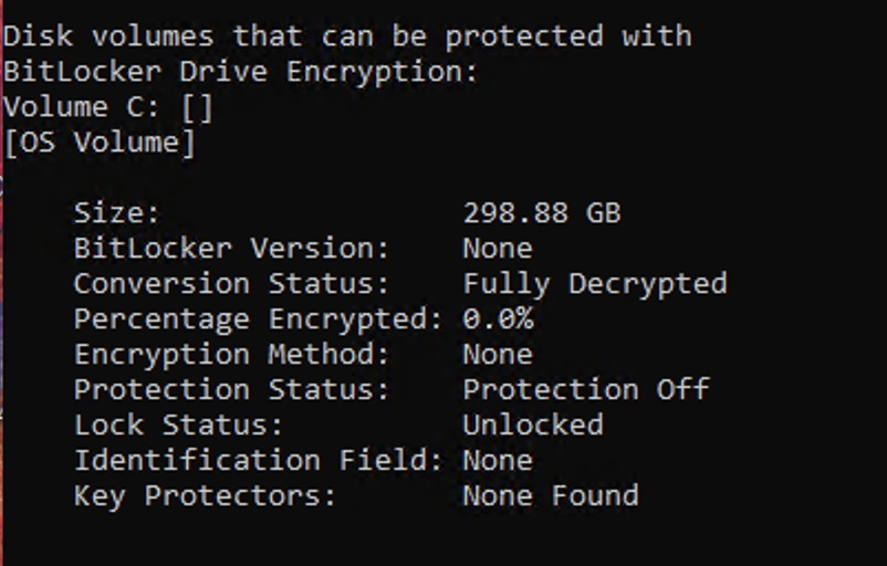

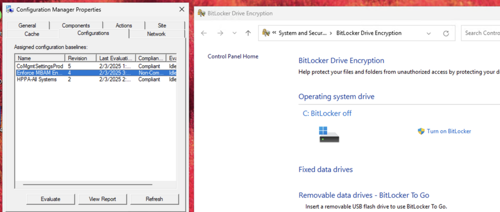

I replicated the same process on my test VM (decrypting with the policy and then re-encrypting using the policy), but for some reason, I’m encountering the same error message as I did on the other devices. Initially, I deployed the BitLocker policies in a smaller controller environment with VMs, and everything worked fine. I’m not sure what might be causing this issue now. The only difference I can think of is that the previous environment was running with self-signed certificates, whereas now it’s running with proper certificates.
- Device status before the decryption policy is deployed.
- Device status after the decryption policy was deployed and enforced.

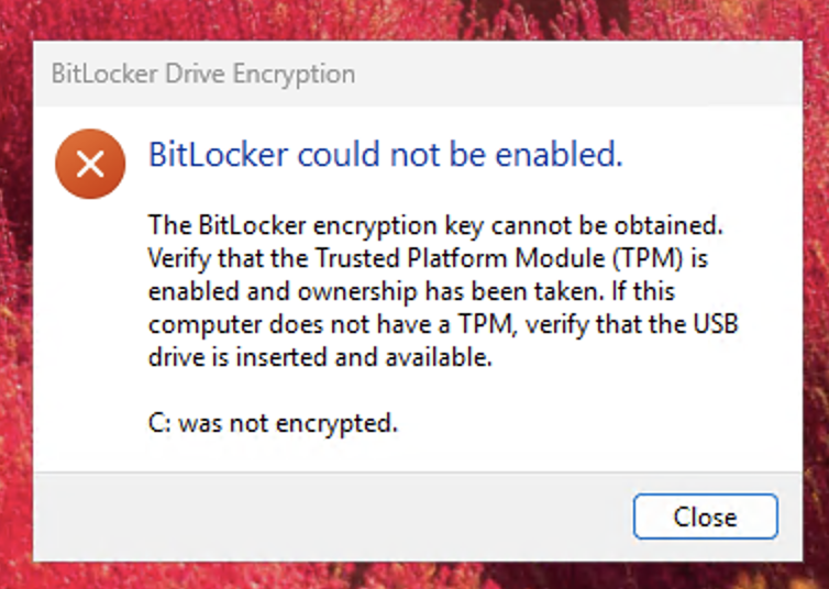

- Trying to re-encrypt after a successful decryption.

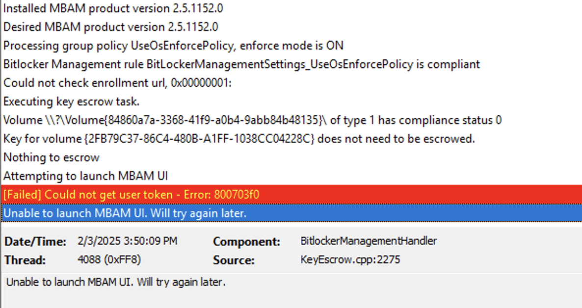

- BitlockerManagemetHandler.log file after encryption policy is deployed
- After rebooting the VM, the next console login via the MSTSC.exe client shows the following:

I have figured out the problem. The issue stemmed from the fact that I was primarily working with headless computers in my environment. Even though I was running MSTSC with the /admin or /console switch, I never properly checked if the established session was, in fact, a console session. This is why the policy would fail, and we would see errors in the logs when the policy attempted to launch the MBAM UI.
I didn’t realize this until I revisited my VMs and accessed them through the console, instead of connecting via MSTSC. On existing, imaged devices, I was able to resolve the issue by manually interacting with a few devices using SCCM's remote control viewer, which establishes a console session. After logging in via SCCM’s remote viewer, the BitLocker policy executed and encrypted the drives without any issues.
