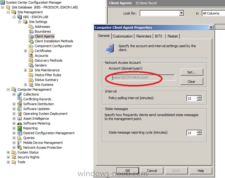

seems that ,Package KIE00002 is missing in DP.ensure you have KIE00002 is avilable in DP(try Updating the DP) also ensure the Network Access Account enabled which can be set from site management--->site settings-->client Agents-->computer Client Agent properties. I think you have not enabled the NAA.

Edit: You are rigth i haven't added the NAA...the NAA must be the network administrator account right ?

No,shouldn't be member of network Administrator .You can create a normal domain Account which you can use it as Network Access Account .
