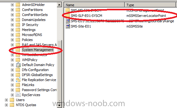

check out ,if you have the below entries for SLP in System Management container.
I chose do not connected SCCM to AD. So, when I need to add a computer to a collection, I use "Computer association" ( Import computer information => Single computer)
So, I haven't got this option in my AD. It's not existe a configuration file which containt configuration to delete. So, the computer must be search and find the new server, like a new computer in deployment.....?
Thanks in advance.
Best Regards
SLP entries can be published in AD(schema Extend) only if you have SLP role created for SCCM site server . can you check in Active Directory users and computers(dsa.msc)--->Domain-->system--->system Management (To get this,enable advance Features from View)
As far as I understand this issue, I assume the AD is not extended for SCCM. Which means, like Konetie says, you need a Server Locator Point (SLP) to tell the clients where to find the Management Point (MP) of the Site. As the AD is not extended there is no use in searching the AD for a record that doesn't exist :)
A client can only find an SLP, when the SLP is published in WINS, or when the SLP is specified in the installation properties of the client (http://technet.microsoft.com/en-us/library/bb694195.aspx)
