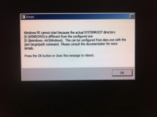

My current issue is this: (the error I get is attached)
windows PE cannot start because the actual systemroot directory (X:\Windows) is different form the configuired one...
I will also attach the smsts.log and the smspxe.log files. Hopefully these things will help you!

your failure, baseed on the logs provided seems to be here
<![LOG[Failed to locate the local data path. The files needed to resume the task sequence are missing. This could be because the task sequence finished while in Windows PE. Please check the largest available partition for SMSTSLog\smsts.log file for more information.
The system cannot find the file specified. (Error: 80070002; Source: Windows)]LOG]!><time="11:17:02.912+240" date="08-30-2010" component="TSManager" context="" type="3" thread="7444" file="tsmanager.cpp:1106">
<![LOG[Task Sequence Manager could not initialize Task Sequence Environment. code 80070002]
so can you tell me a bit about how you set up your task sequence, how are you executing it etc..

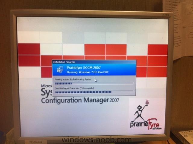

I have solved the issue I get with the WinPE crapping out, the issue was that I had to re-create the WINPE image, I think this is because the img I was using did not have the 3 windows components that SCCM2007 requires to use (scripting, wmi, and xml)(xml is included in all base winpe images nowadays)...SO now I got to the part where the client actually downloads the .wim image and applies it, it got through about half of the application and then crapped out to this error code
0x80070032
the smsts.log is located in C:\Program Files\SMS_CCM\Logs for me but it has not updated since early yesterday morning but since you said that i should check my largest partition I assume that its not the one you want me to check:
I found the 1 on my D partition(largest)
this one has not ben updated since 6/24/2009!
Any suggestions?

Also this is my imaging process...I'll explain it to the best of my ability!
I have a custom collection in which I added my lab box to using the computer association feature and I refresh the clients ability to get an OS deployed to it by clearing the last pxe advertisement and using the query feature available in the collections settings.
I use the WInPE x64bit image as the lab box is of 64bit architecture (quad-core).
I created a package under operating system images in which its a base 32bit Windows 7 one (already been captured manually by me using the imagex cmd from WinPE)
I created a task sequence for it and made sure to use the 64bit WinPE boot image.
Em assuming that the info I just gave you isn't the most descriptive or enough-please let me know what other information I should provide.
