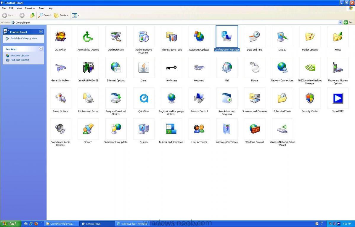

My ccmsetup.log file content, on the last line it says it was uninstalled, however I still see the configuration manager in the control panel:

Control panel picture of the PC at 3:00pm is attached which shows my configuration manager still present, and I can't seem to install the client on the machine via my server side.
