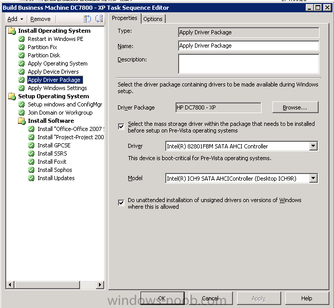

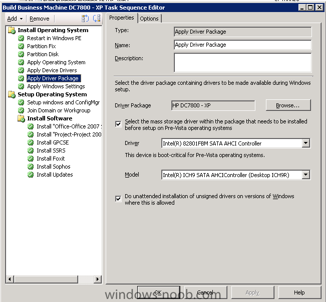

I have created an image using SCCM on a VMWware virtual machine (so no HAL/driver issues)
I am now attempting to deploy the image to HP DC7800. As soon as the machine reboots after the Setup Windows and ConfigMgr TS step. It goes just reboots even before the XP splash screen. If i press F8 during boot up into advanced boot up and select "No reboot on error" i can see the STOP error 0x000007B.
I have tried everything recreating Driver packages, removing mu Nlite built XP Files and replacing with normal XP files. I have implemented categories and have an Apply Driver Package and Apply Device Drivers TS step.
I have also switched off RAID mode in the BIOS and use IDE instead, still get the same error. I have also put in the BIOS fix OSDDiskpartBiosCompatibilityMode=TRUE.
I've attached an SMSTS.log
This below is from SCCM report.
"The task sequence execution engine successfully completed the action (Apply Device Drivers) in the group (Install Operating System) with exit code 0 Action output: 5988AE59F9D36E63EBC52913B22C28_72FBC442A267FE46E66EE739FF03179649C49C04 (SMS Driver Rank = 0x0001) Driver "High Precision Event Timer" has already been installed. Failed to find a suitable device driver for device 'HID\VID_050D&PID_0119&MI_00\7&33543E70&0&0000'. Ranking compatible drivers for IDE Controller SCOPEID_0FADB8DF-4D53-45E0-9EC1-DF86012F9B47/DRIVER_4995498348C395CA471F508ADBCF5467D1C1E226_72FBC442A267FE46E66EE739FF03179649C49C04 (SMS Driver Rank = 0x2001) SCOPEID_0FADB8DF-4D53-45E0-9EC1-DF86012F9B47/DRIVER_EA91CCCCF1EFDEB3D57DC742DE92CD2F839A4B25_9AAE6CF85E96E6CD7B09BA9982654A69D90A3596 (SMS Driver Rank = 0x2001) Driver "Intel® ICH9 4 port Serial ATA Storage Controller 1 - 2920" has already been installed. Driver "Intel® ICH9 4 port Serial ATA Storage Controller 1 - 2920" has already been installed. Failed to find a suitable device driver for device 'ACPI\PNP0200\4&38240245&0'. Failed to find a suitable device driver for device 'ATA Channel 1'. Exiting with return code 0x00000000. "
