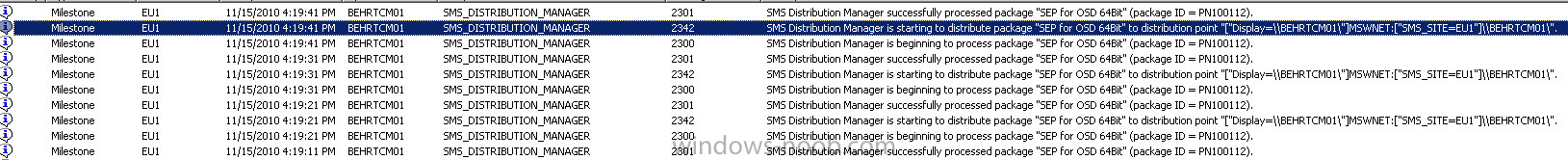

About half of my servers are showing some pretty strange behavior.
They do still work, transfer packages and generate logs, they also do not report any errors, but are just processing the same things over and over again.
I included a screenshot of the log of one server.
If somebody has any idea why this happens, or how to resolve it, please speak up.

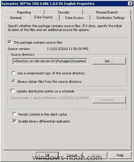

Check the package schedule(right click on package-->data source) how it is configured ?
also ensure,if some one Updated the package either by rightclick -->update pckage or modifying the source contents etc?
Nothing special configured and that particular package has not been updated since it's creation.
