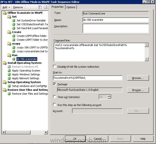

Ok, I've tried this several times and its failing at the do x86 scanstate with this error task sequence has failed with the error code (0x00000001) I'll attach the log file, there was this error in it: Error Task Sequence Manager failed to execute task sequence. Code 0x80004005. I appreciate everyone's help...its definately a good learning process :)
Also, just found this error in the log:
Failed to run the action: do X86 scanstate.
Incorrect function. (Error: 00000001; Source: Windows)]LOG]!><time="12:14:40.033+300" date="11-26-2010" component="TSManager" context="" type="3" thread="1136" file="instruction.cxx:3101">
