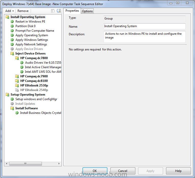

HP dc7800 Small Form Factor Workstation not installing drivers that we setup in a Task Sequence
post-7654-129204021753_thumb.jpgI have setup a task sequence to install 4 different driver for the HP dc7800 Workstation. I've followed this guide: http://www.windows-noob.com/forums/index.php?/topic/563-how-can-i-target-applications-to-specific-hardware/ step by step and for some reason it will by-pass installing these four drivers. Here are the drivers I'm trying to install:
Audio Drivers Ver 6.10.7255_sp45615
Intel Active Client Manager HECI Device_v3.2.20.1046_sp46137
Intel AMT LMS SOL for AMT 3.0 Ver 5.4.1.1051_sp46134
NVIDIA Graphics Driver Ver 8.16.11.9142_sp48413
I've downloaded all four of the drivers from the HP site, and I have extracted the files. I have created four separate folders with the extracted files, and followed the guide above to set all four of them up. I can get the dc7800 workstation to image, but these particular drivers for whatever reason won't install in my Task Sequence. All four of the "Readme" file says you can use the silent install by using the "setup.exe -s". I've got all four of the drivers setup with a WMI Querey which is: SELECT * FROM Win32_ComputerSystem WHERE Model LIKE "% HP Compaq dc7800 Small Form Factor %". It almost seems like it skips over installing these four drivers.
Any help would be greatly appreciated.
