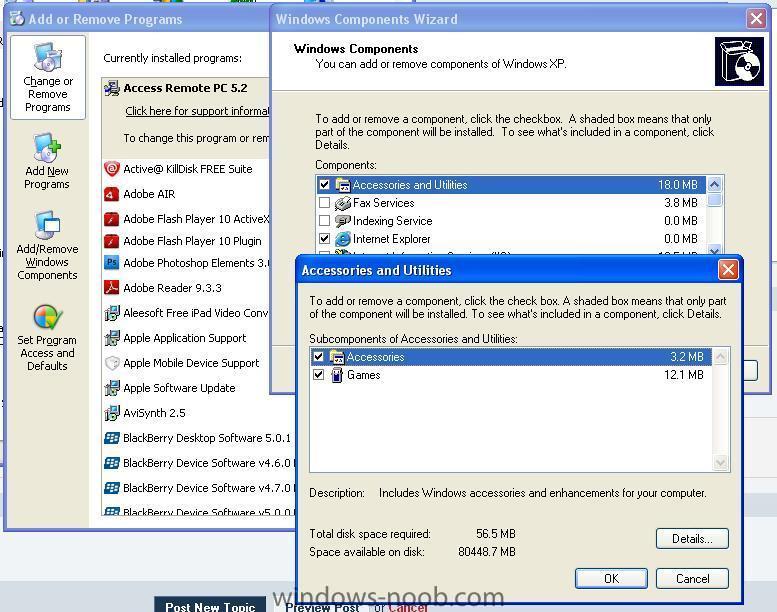

maktoum Posted January 3, 2011 Report post Posted January 3, 2011 Hi I'm trying to find way to uninstall games and windows messenger which are available under windows components in Add\Remove Program by SCCM 2007 R2.. Hopefully find somebody did this before ... Quote Share this post Link to post Share on other sites More sharing options...

0 maktoum Posted January 12, 2011 Report post Posted January 12, 2011 Hi again I solved the problem If I want remove some windows components and some of that component is already removed (Ex. spider game)the advertisement will not working well it will give you an error meg that you exceed the allow time but when i tried push the package to machine have that components it working fine. Here is the steps to remove some of windows components (Games and messenger): 1. create txt file contain windows components name as following Components] msmsgs = off Freecell = off Hearts = off Minesweeper = off Solitaire = off Spider = off zonegames=off then save it in sccm server inside shared folder DWC and give it name DWC.TXT http://support.microsoft.com/kb/222444 2. Copy Sysocmgr.exe file from windows machine and save it in DWC folder. 3. Use the command line: sysocmgr.exe /i:%windir%\inf\sysoc.inf /u:\\SCCMserver\DWC\DWC.txt /q * Run: Normal * After Running: No action required * in Environment tab set these: Program can run “whether or not user is logged on” & “run with Administrative rights” & "all users to interact with this program" 4. Create advertisement and push to test collection 5. Go to client machine and & initiate actions: a) "Machine policy retrieval & evaluation cycle" “User policy retrieval & evaluation cycle" the above 2 steps is only to fasting receive the package no need to wait long time. 6. Checked the Cache folder and make sure the machine receive the package. Note: If some of components in the txt file already uninstalled the advertisement will not working. Quote Share this post Link to post Share on other sites More sharing options...
