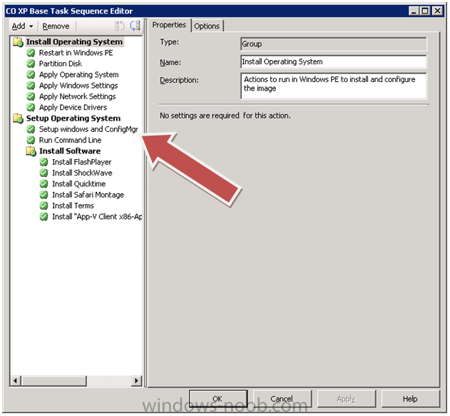

We are using SCCM 2007 R3; we have several task sequences configured and working just fine via PXE boot. But if we try to run the TS from within Windows (Run Advertised Programs,) the TS only completes up to the "Setup Windows and ConfigMgr" and then boots to Windows OS. So the computer joins the domain, but doesn't go back into WinPE and finish installing software in the rest of the TS.
Someone suggested building a new TS from scratch, but the same thing happens. My off-the-wall theory is that it has something to do with where/how the PE boot image is stored on the hard drive when deploying from within the OS, as opposed to using PXE-boot which doesn't store the boot info on the hard drive (I think.)
Does anyone have a thought or suggestion on what could be causing this to work one way but not the other? Thanks in advance for any feedback.

and just to clarify a little, the computer boots up and does the Windows XP Professional Setup and does not appear to boot back up into WinPE. When the OS comes up and I login, there is no Configuration Manager in the Control Panel. So it doesn't seem to be getting through the "Setup Windows and ConfigMgr" step.
Hope this makes sense; thanks for taking a look.
