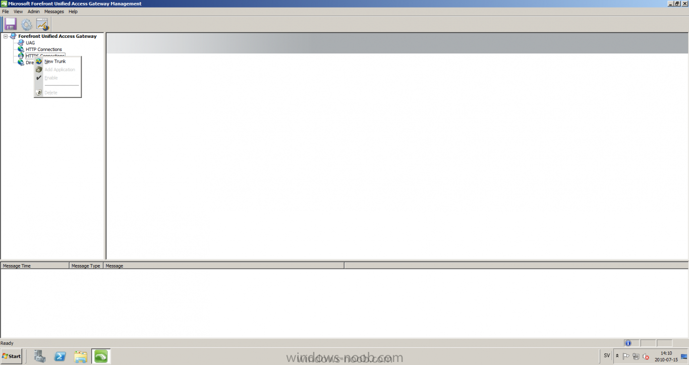

Start with creating a HTTPS trunk by right clicking the HTTPS connections
I will create a HTTPS trunk just for this purpose.

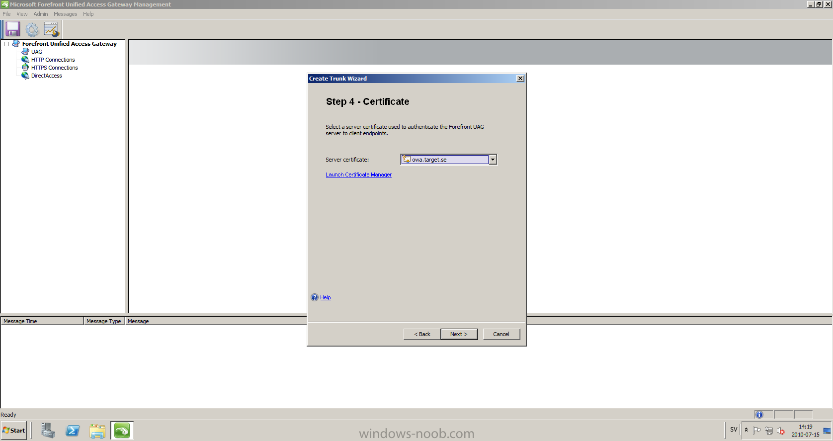

It's time to choose the correct certificate so the name matches each other, in my case it's: owa.target.se.

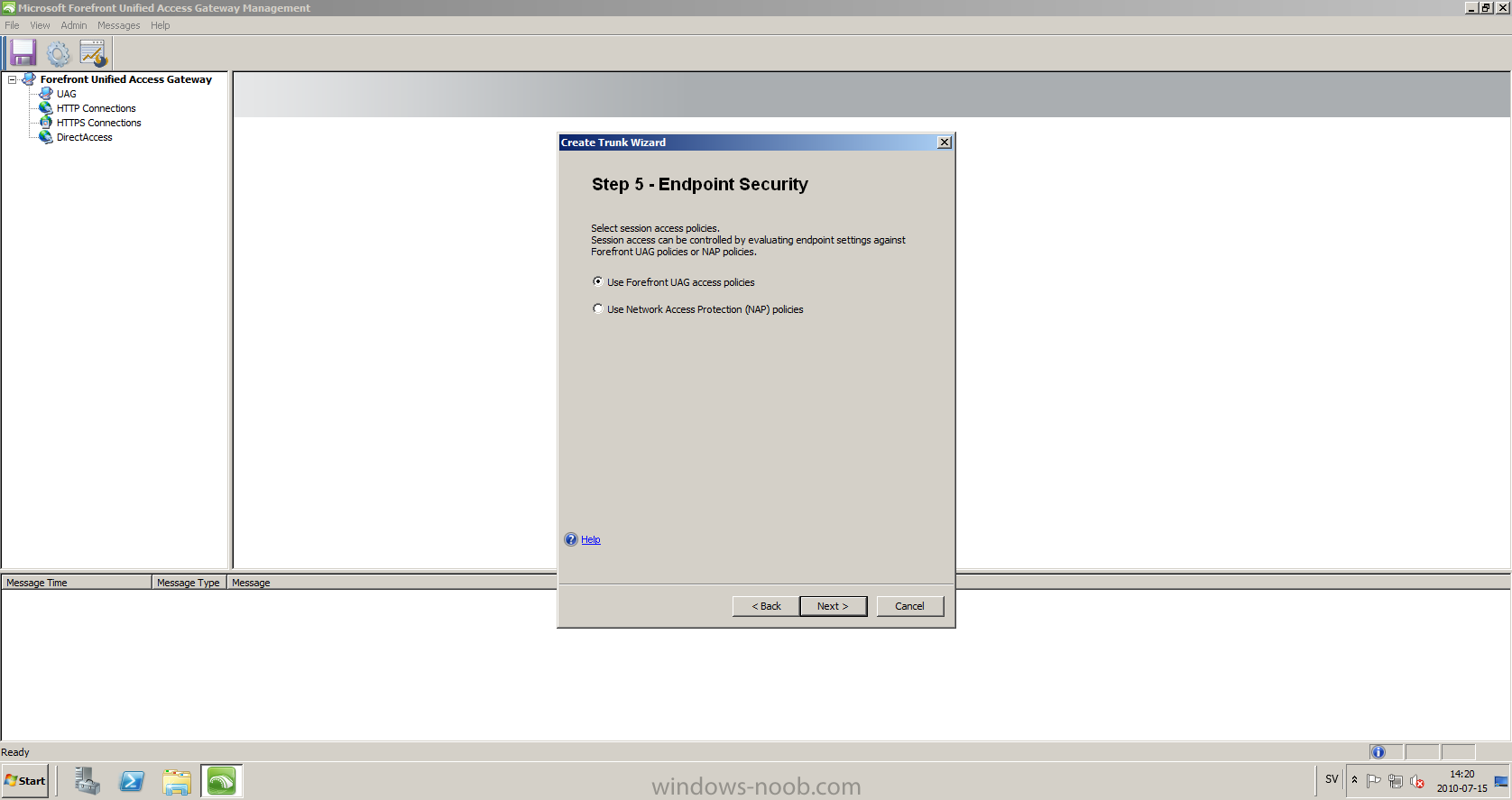

Step 5 will be to select endpoint security, I don't have any NAP servers so I'll select Forefront UAG.

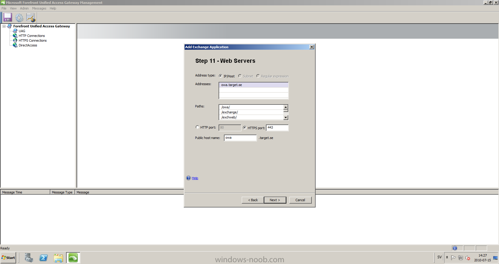

Step 11, Select Web servers
In address field I type in; owa.target.se, or could be fqdn of the server.
This name will be resolved on the UAG to my Exchange server since it's added to the host file.
Double check so the Public host name is configured correctly; owa.target.se

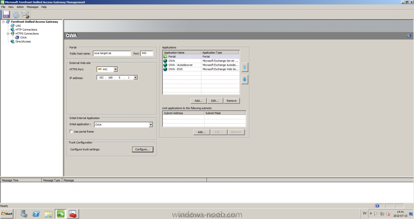

When all steps are configured it will look like this
Don't forget to save and active the settings, or else it will not work :-)

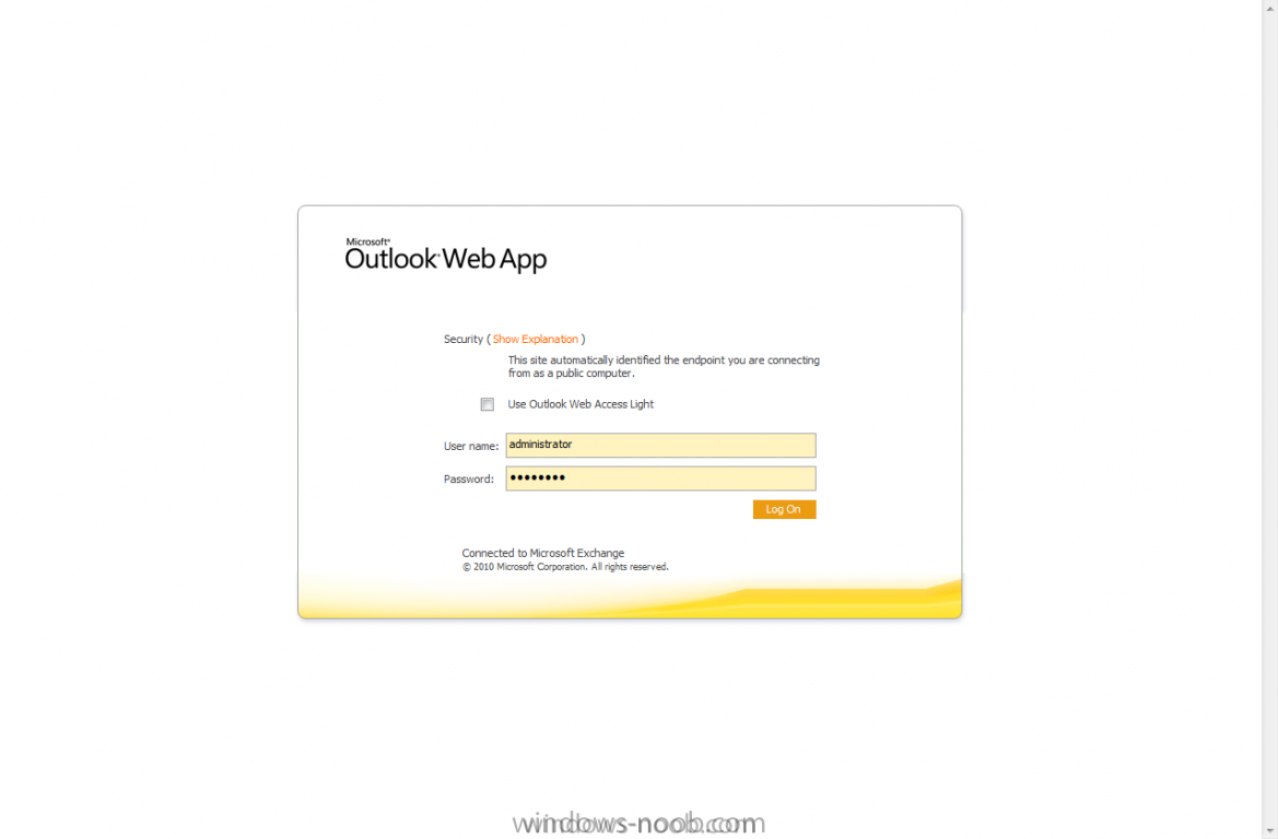

Let's start IE and go to https://owa.target.se/owa
I went successfully into the OWA
Successfully authenticated and logged on!
