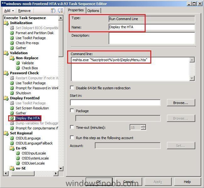

At the beginning of your task sequence create a Run command Line step with the following in it
mshta.exe "%scriptroot%\wnb\Deploymenu.hta"
let me explain what is happening in this step...
The mshta.exe file is like a web browser and displays our HTA (hypertext application).
you'll notice i'm using a path to our HTA which is "%scriptroot%\wnb\Deploymenu.hta" that is because I place the HTA files in a sub directory of my MDT toolkit scripts directory (MDT Toolkit scripts directory=%scriptroot%).

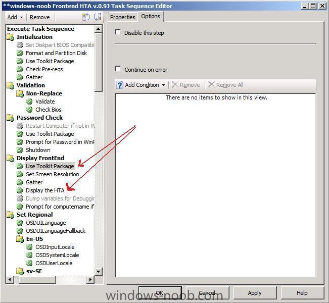

This is not possible without a Use Toolkit Package step shortly before this step otherwise the %scriptroot% variable won't be set, so prior to this in my Task Sequence I have a Use Toolkit Package step.

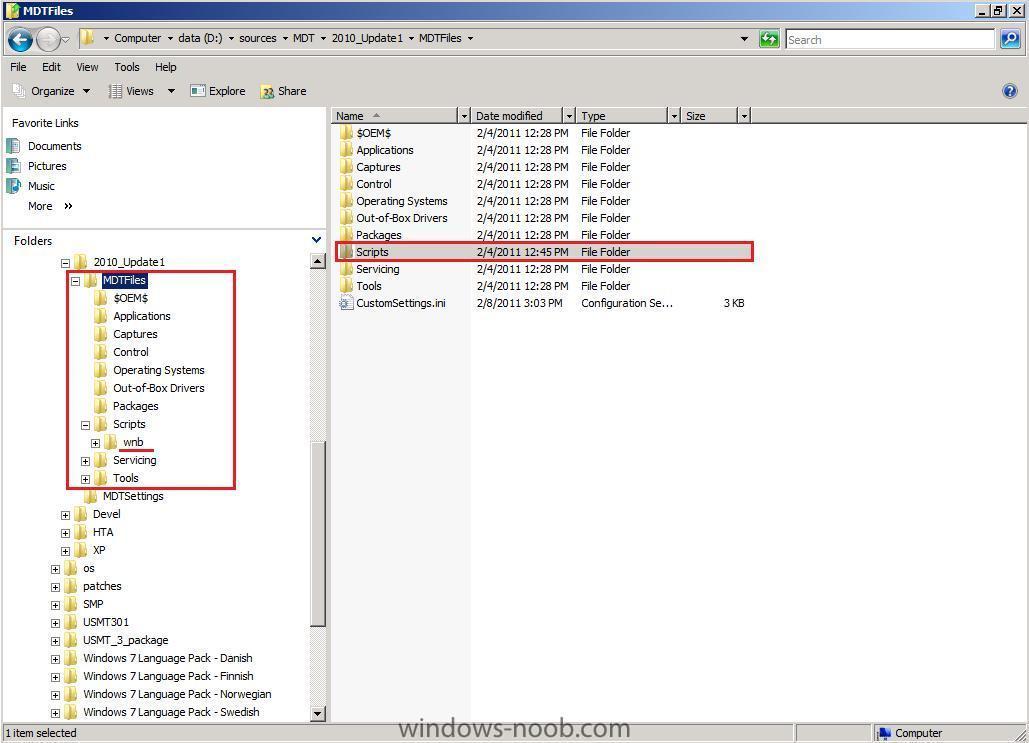

To copy your HTA file(s) to a sub directory in your MDT Toolkit package, locate the package source in ConfigMgr, find the scripts directory and create a new sub directory called My_Custom_Scripts (or whatever you want) which contains your scripts. In my example the sub directory is called wnb and I place my HTA file and all supporting scripts in there. Don't forget to Update your distribution points for your MDT Toolkit package after copying the new scripts/files.

by attaching the hta to the toolkit package i know that my hta plus the scripts it has will always be available when i have the mdt scripts available (which is what the use toolkit package step does), it downloads the content (the files/scripts) and sets some variables (path etc)

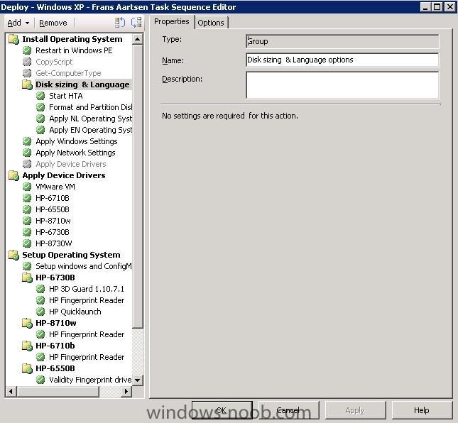

I copied the HTA to a folder in the root of the WINPE wim file.
That is why I called it directly with the command line.
I saw the toolkit package step in your tutorial, but have no clue what it does.
So could you fill me in, who knows it makes me see why, what etc and make it work...
