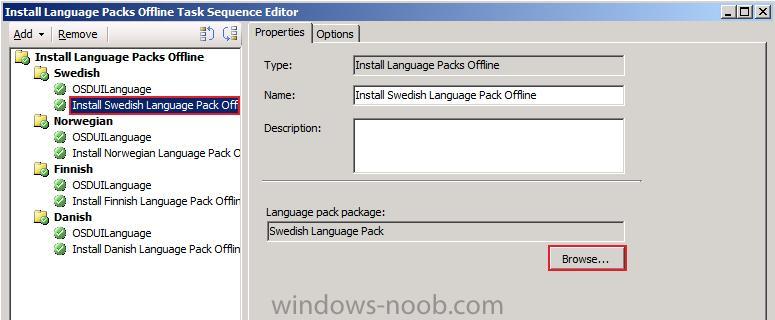

Ok let's look at the steps themselves and see what they do.
The Swedish sub Group is responsible for installing the Swedish Language pack if a variable called languageValue=Swedish. How you set that variable is up to you, you can set it via a FrontEnd HTA (recommended) or by simply using a Set Task Sequence variable step (before this Group) such as this (not included in the sample task sequence):-
Task Sequence Variable: languageValue
Value: Swedish
If languageValue is determined to = Swedish it then carries out two steps
Sets a task sequence variable called OSDUILanguage = sv-SE
and then calls the built-in MDT Step, Install Language Packs offline (which references the ZTIpatches.wsf script). This step points to our previously made Swedish Language Package.
The actual step takes some minutes as it has to expand lots of files in the cab, and inject them offline (using DISM) into our Windows 7 image.

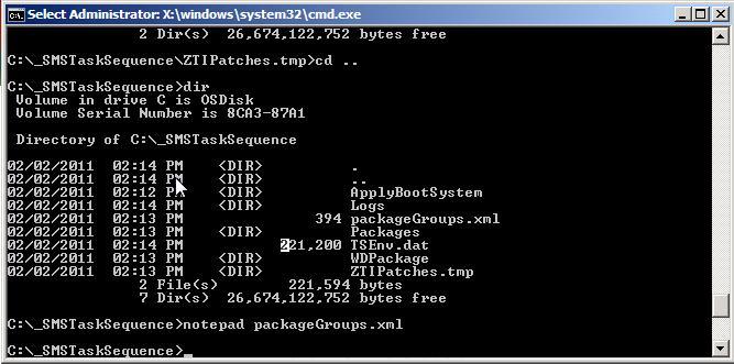

After the Install Language Pack Offline step the following will be created in c:\_smstasksequence\
namely:-
Packages<dir>
ZTIPatches.tmp
packageGroups.xml
in the Packages directory you’ll have more subdirectories based on how many lp’s you included, one language pack, one dir, 4 language packs in your ConfigMgr Language Package, 4 dirs...
you may also see a directory called _smstasksequence\SMSOSD\osdlogs and in there are three files including a log file called BDD_PKGMGR.LOG, analyse it if you are having issues deploying Language packs offline as it will reveal the success or failure of the DISM operations.

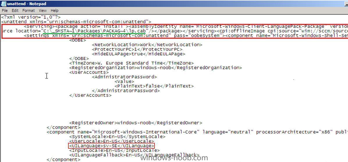

Before the Setup Windows and ConfigMgr step is complete you can monitor c:\windows\panther\unattend\unattend.xml to see what is happening in relation to your modifications taking place or not
After the Setup Windows and ConfigMgr step is complete, you’ll see the following has been added to your c:\windows\panther\unattend.xml file. If it is not added or if there are no changes to the %OSD...% variables then something has failed and it's time to troubleshoot.
Note: The above locations are during the Windows PE phase. After the Setup Windows and ConfigMgr step is complete it will reboot your computer (unless you have a command prompt open in WinPE), and after that reboot the unattend.xml file will have been removed (by the Setup Windows and ConfigMgr step...).

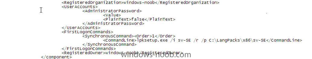

If you want to install language packs online, you can use the MDT step in your task sequence or indeed add the Language specific code in your unattend.xml by clicking on Insert, choose Pass 7 oobeSystem
And paste the following line in
Lpksetup.exe /I %OSDUILanguage% /r /p C:\LangPacks\x86\%OSDUILanguage%\
The Lpksetup tool does not process language packs in any configuration pass other than auditUser and oobeSystem.
After the installation of Windows 7 (right at the end after you login for the first time…)
You’ll see – (if deploying Language Pack online and if you login as an administrator)
long story short the following will end up in your unattend.xml if doing an language pack ONLINE installation
