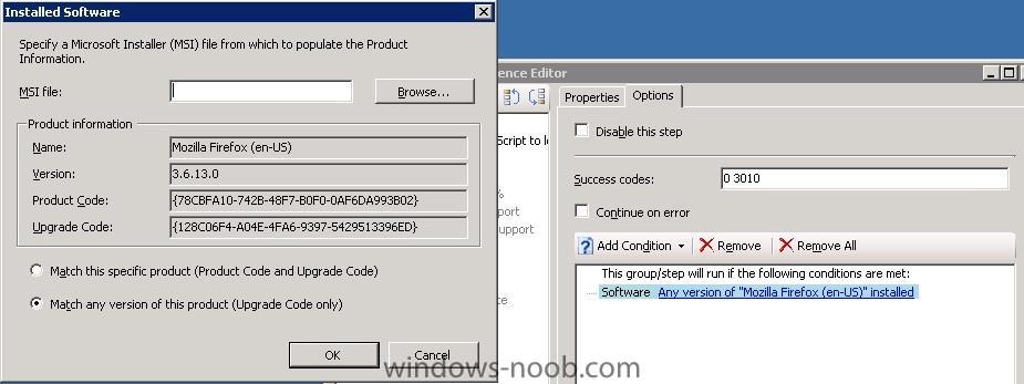

Hi again. Do you know a way to find any version of a program without the localization. As you can see from my screenshot i am able to uninstall all Firefox en-US but it is failing for GB. Only way is to edit my msi with an msi editor? What is the reason of having a condition if we want to uninstall all versions? If i remove the condition it can not find the software on the client to uninstall it.

Hi thanks for replying. I actually made a collection based on Add/Remove Programs having %Firefox% installed so i know they have the program. but with the condition removed as well it does not work for a majority. Will have a look again on Monday and let you know if i found anything else.

The script says that package not found so i don't think that continue on error will work. is as if its different upgradecode. Will check again.
