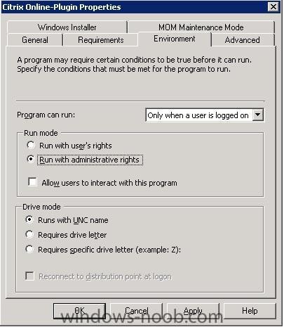

  On 3/1/2011 at 6:47 AM, YiannosG said:
On the program you are running check these settings.
Yes,
this runs the command at NT Authority/System.
