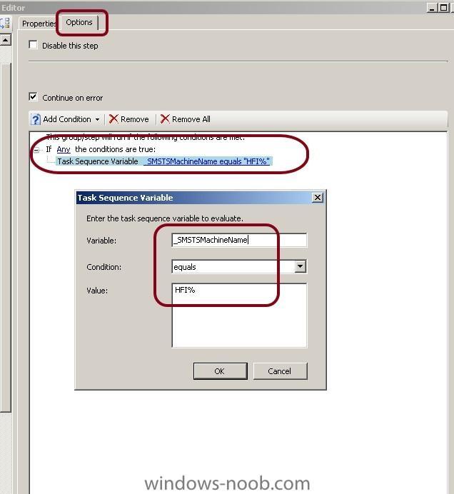

Hello all,
i've been using SCCM to Deploy a image of our XP Machines. Works pretty well except for one thing.
We identify our machines by our site codes, which differ for each country. Now i want to deploy software during my OSD TS only to choosen countries.
The machine is named and joined a domain already.
I want it to be decieded by the computer name it has.
What I tried is using if normal TS Variable _SMSTSMachineName equals "XXX%" where the XXX identifies the site, followed by model and our own unid. That did not work as he could not find a match here. I've tried on reading up on MS and other forum but somehow i do not get further with that question.
Maybe someone can shoot me a hint in that direction.
Any help is appriciated. Thanks!

  On 4/18/2011 at 2:42 PM, Lucid said:
Is this for a WMI query? Did you try using "LIKE" instead of "EQUALS"?
I wanted to use a normal TaskSequence Variable. If you choose that in the TS it offers you only equals or greater than etc...
I don't know if i could use a normal WMI query as I am not sure that the computer name object is already set then?
I ahve attached a picture to maybe make my problem more clear hopefully. :)
