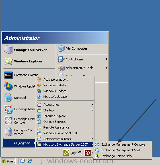

Step 1.
Startup "Exchange Management Console" (EMC).

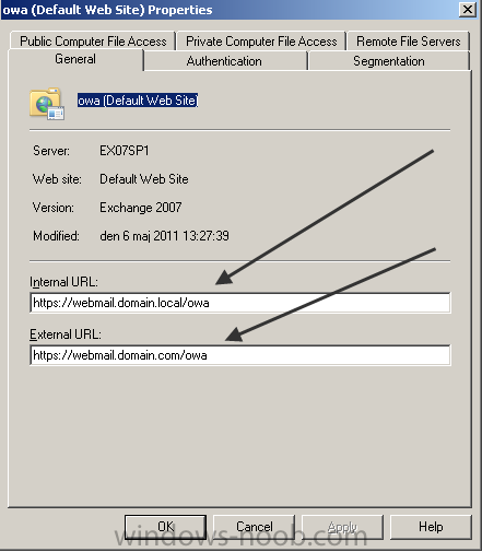

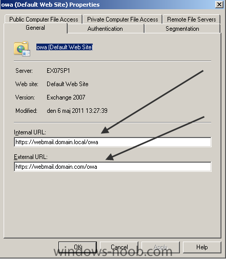

Right click and select Properties and type in the Internal and External URL for OWA.
In my case I've used" https://webmail.domain.local/owa" as the InternalURL and https://webmail.domain.com/owa as the ExternalURL.

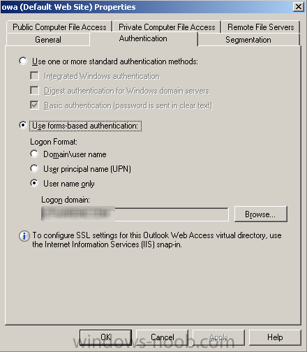

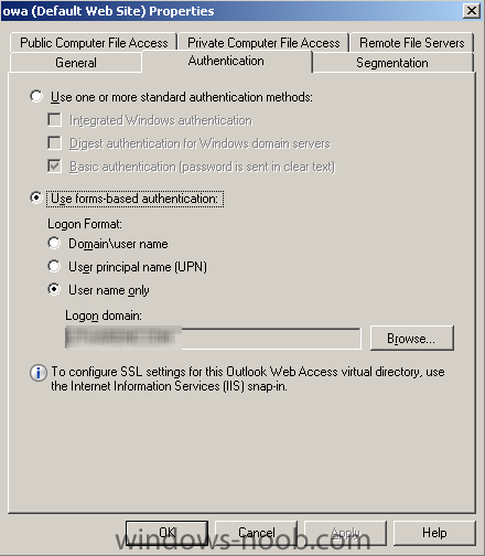

Also go to the tab Authentication and select "Use form-based authentication" and choose "User name only" and browse for the domain.
