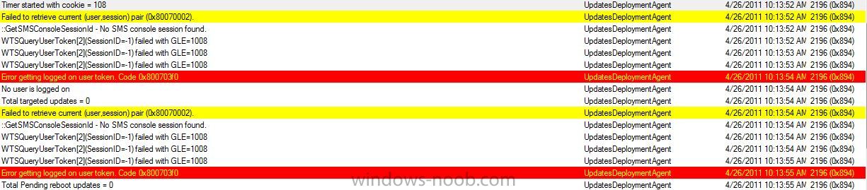

ok I snagged all the log files after the TS failed the "install updates offline" attached is a screen shot of the updatesdeployment.log. That shows the 2 repeating error messages.
I've got all the other logs. I'm going to browse through them and see if anything else stands out.

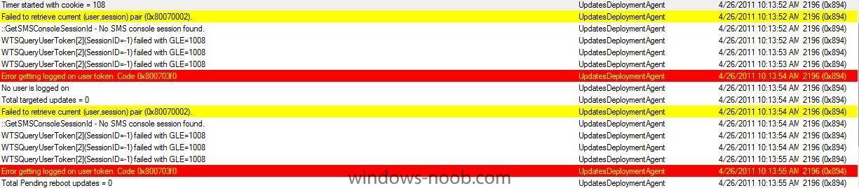

I keep seeing the Failed to retieve current (user,session) pair, and Error getting logged on user token. error on various other logs as well. Maybe a permission error? I checked and I'm logged in as the local SYSTEM account during the OS deployment. am I missing permissions somewhere for the local SYSTEM account to access the updates path or something like that? I'm still poking around but if you gots some areas for me to check let me know!!!

So after letting this sit for a couple of days and coming back with fresh eyes I'm seeing the issue... maybe? I'm noticing in the portion of the log that I posted that there the "Total targeted updates = 0" so that means that I dont have the updates targeted correctly?

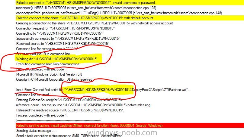

ok I think I might have made some progress. I checked the SMSTS.log and found this portion of it. I highlighted the part that concerns me. "Input Error: Can not find script file "\\hgsccm1.hg\smspkgd$\wnc00015\%deployroot%\scripts\ztipatches.wsf". I DO have the MDT stuffs installed. I tried mapping that location to a drive within the instance of the os deployment and it couldn't find that location.

So i noticed that below it sets the working directory to the server name and package name. Then it attempts to call the script variable location and it adds that to the working directory? I'm looking through the various XML and ini files and havent been able to find out where I can tweak this? Any ideas?
where in your task sequence are you attempting to do this, if it's Install Updates Offline is must be before the setup windows and configmgr step, is it ? in addition you must specify a windows updates pacakge in that step, are you ? lastly just before the Install Updates Offline step you must have a Use Toolkit Package (mdt 2010u1-MDTFiles) step.
eg....
Use Toolkit Package
Install Software Updates Offline
Setup Windows and configmgr
I've just tested it here with windows 7x86 works fine
