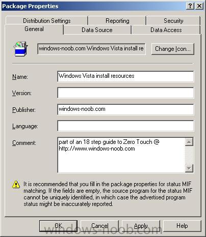

Right click on Packages and select New, for package name, use Windows Vista Install Resources, and if you wish, fill in the extra fields below.

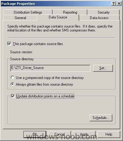

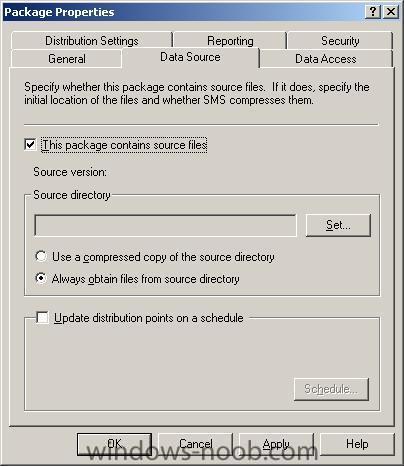

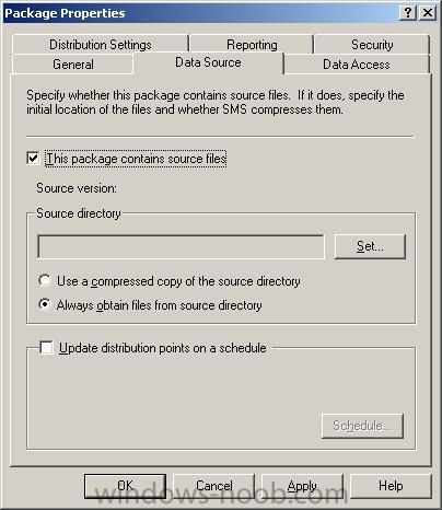

click on the Data Source tab and put a check mark in This package contains source files.

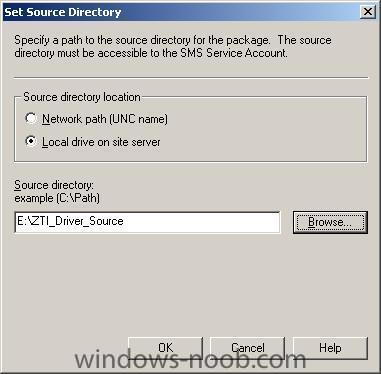

Click on Set and and select Local Drive, and then browse to the ZTI_Driver_Source folder we created earlier. This folder contains the drivers we copied from our BDD 2007 distribution point.

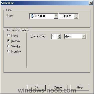

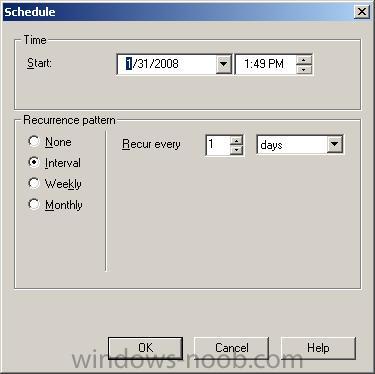

Make sure to select Update distribution points on a schedule
and set your scedule to check if any files have been updated or changed. This makes SMS replicate this package to all the SMS distribution points you select at a predifined interval.
We now have a package in SMS that represents the install resources.
