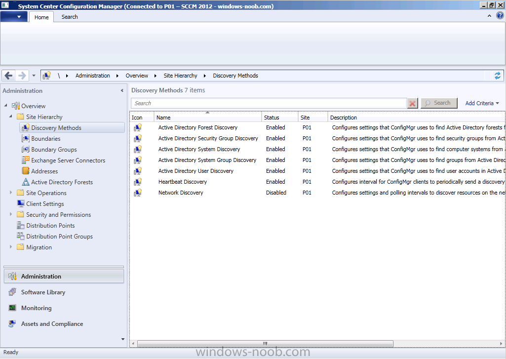

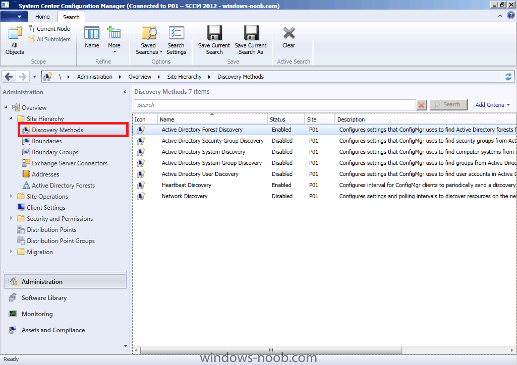

Click on the Administration workspace, expand Overview, Site Hierarchy, Discovery Methods
You can see that we have already enabled Active Directory Forest Discovery (Heartbeat Discovery is automatically enabled), so let's enable some additional discovery methods otherwise our computers (and users) will not appear in Assets and Compliance.

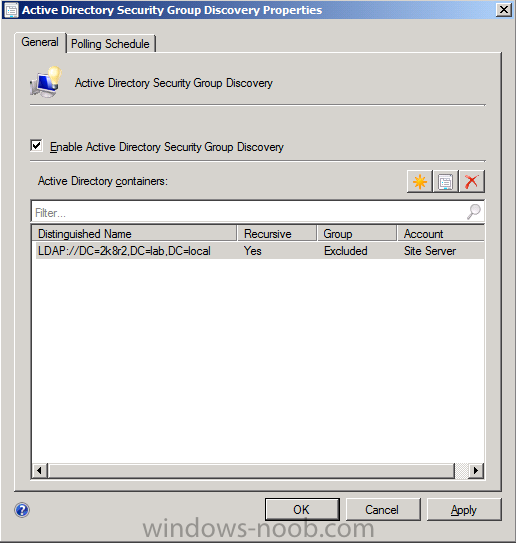

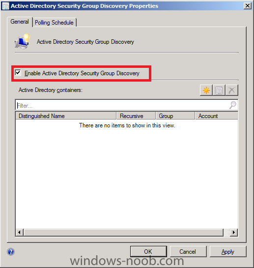

Double click on Active Directory Security Group Discovery, place a checkmark in enable active directory security group discovery

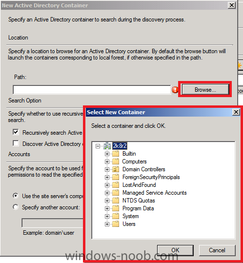

click on the yellow starburst to add an Active Directory container, once done click on Browse and select your chosen active directory container to search during the discovery process
click Ok when done

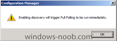

note that enabling discovery will trigger full polling to be run immediately
Step 2. Enable the other three Active Directory discovery methods
Repeat the above for the remaining discovery methods
  • Active Directory System Discovery
  • Active Directory System Group Discovery
  • Active Directory User Discovery
The following Discovery Methods should now be Enabled

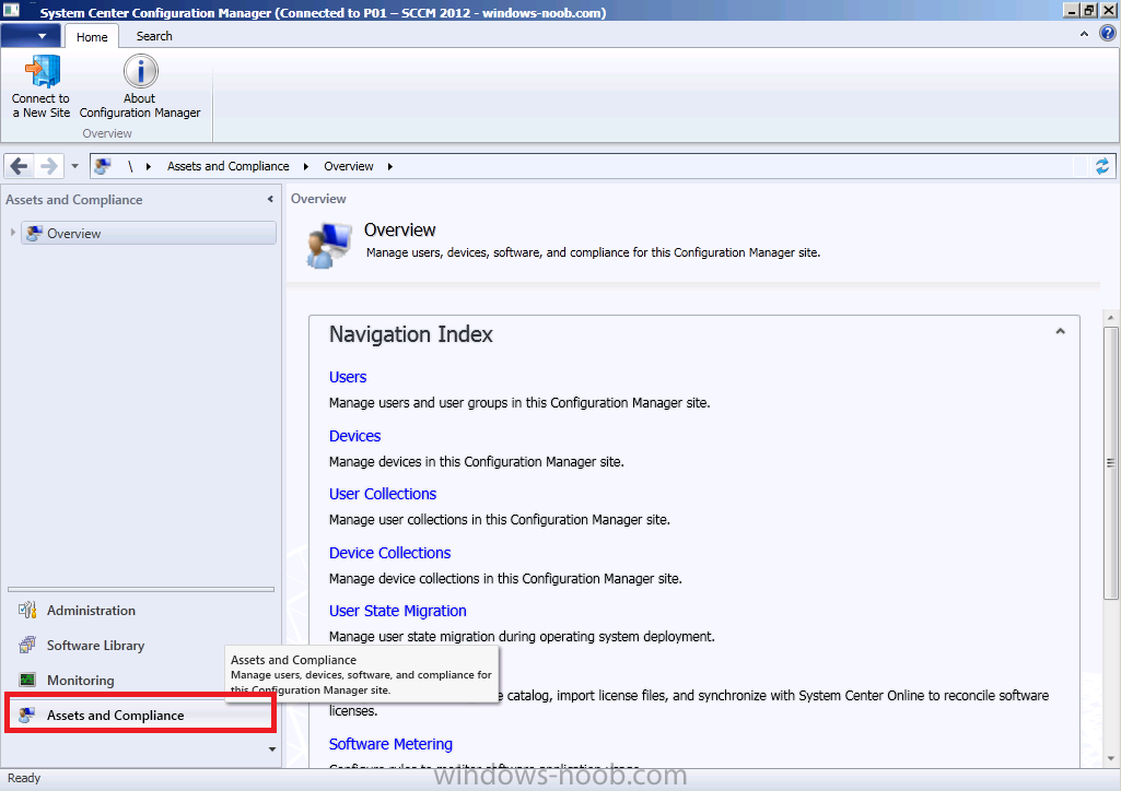

In the console, click on Assets and Compliance

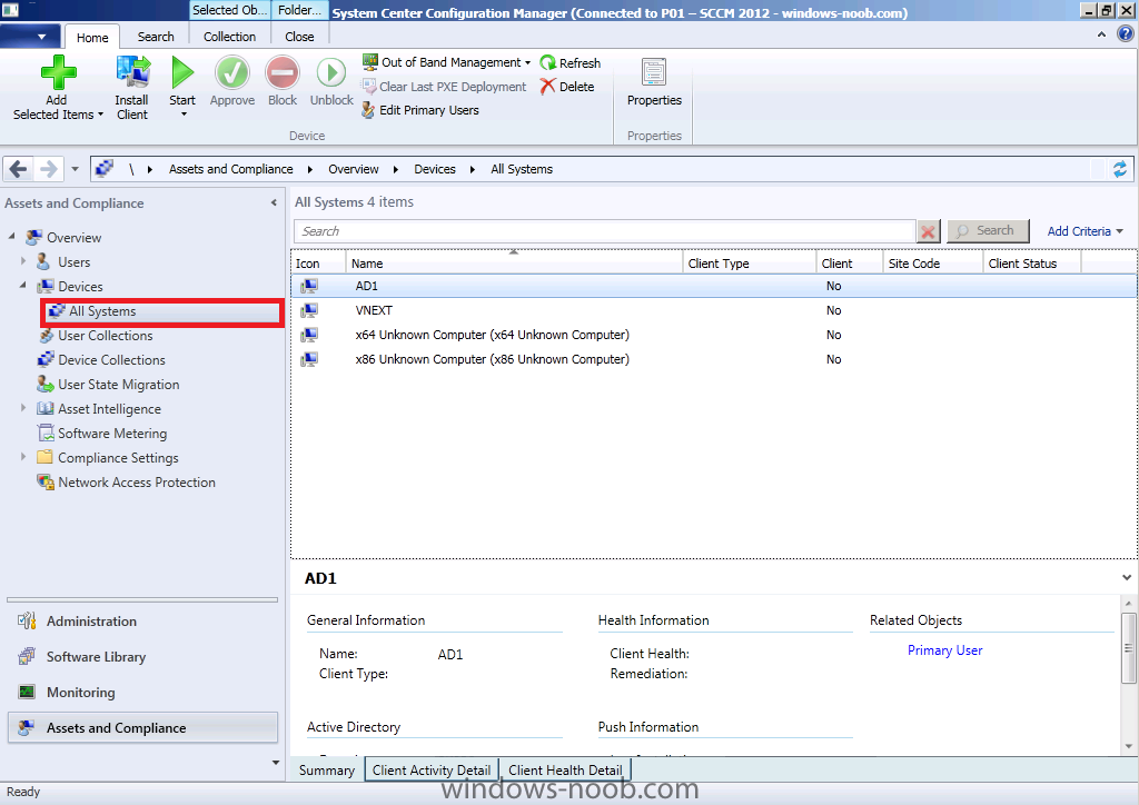

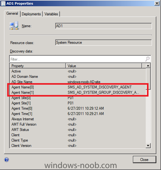

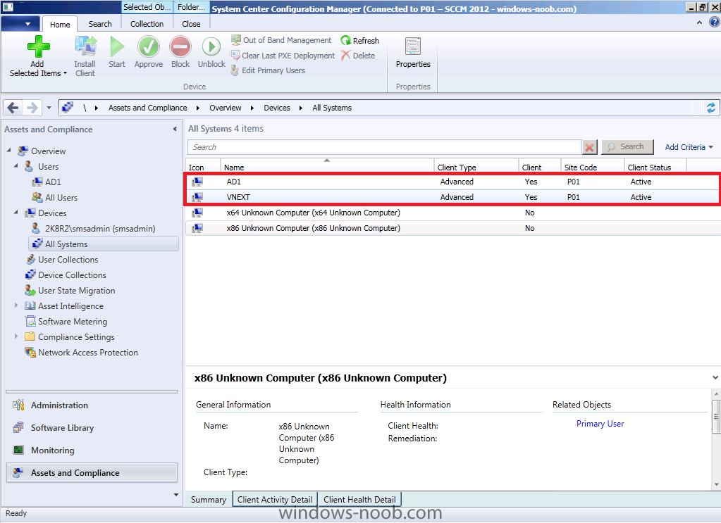

Discovery of Computers

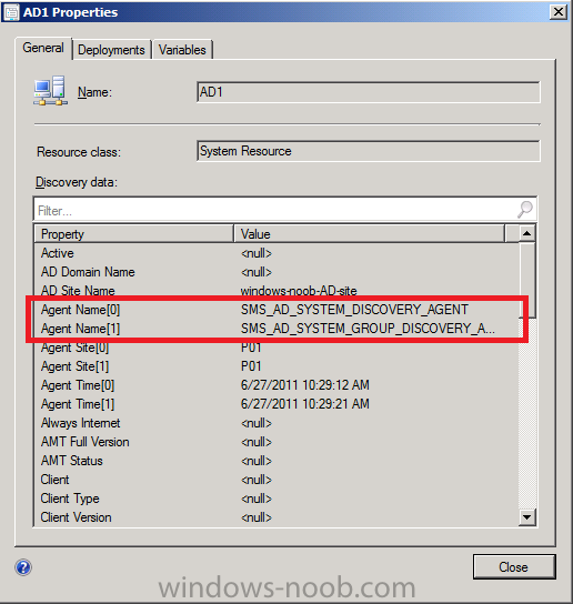

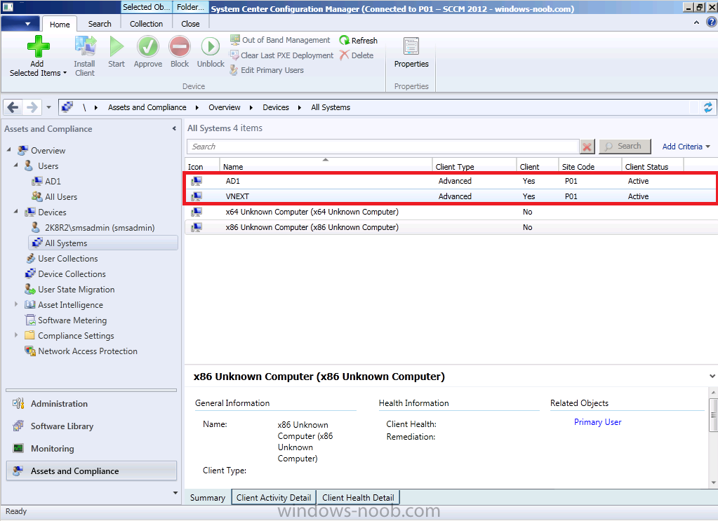

Click on Device Collections, then click on All Systems, you should now see both AD1 (was previously missing) and the vNext server listed.
Double click on AD1 (your Domain controller computer) and you should see details about the system including discovery details (it was discovered using Active Directory System Discovery and Active Directory System Group Discovery).
Click on Close.

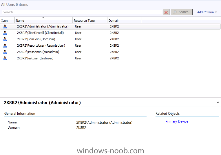

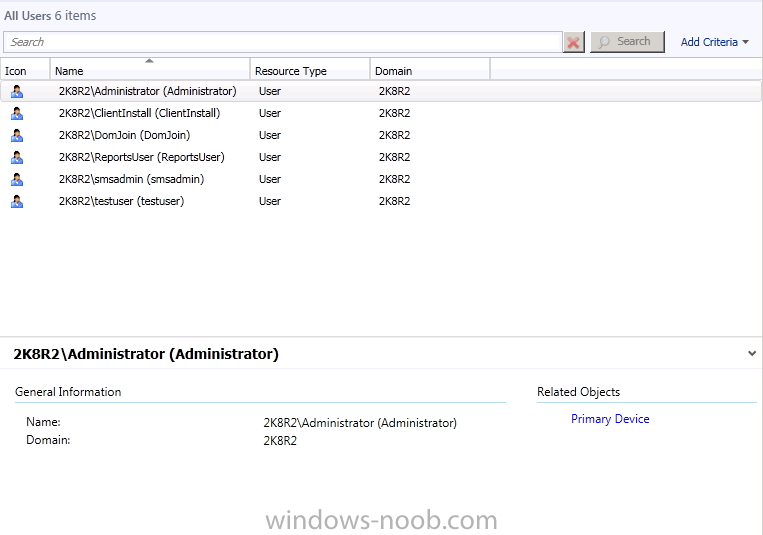

Click on User Collections in the left pane, Click on All Users and in the Ribbon, click on Show Members
the contents of All Users are displayed (these are the users we created in Part 1 of this guide)

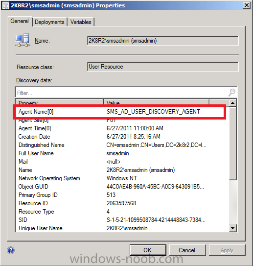

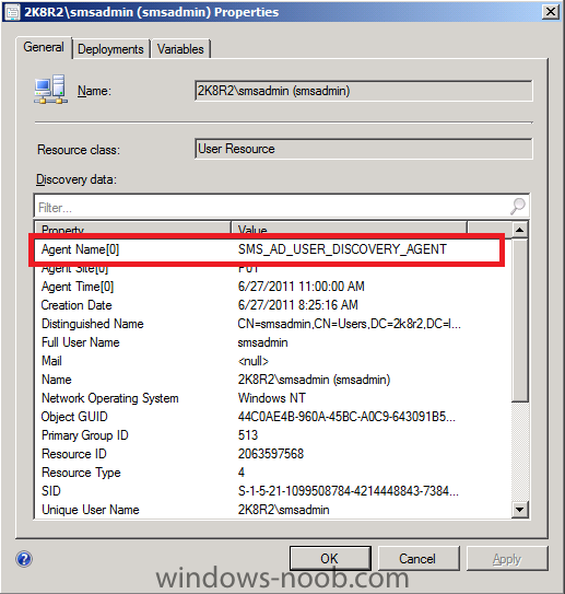

Double click on a user and you'll see the discovery information listed, including discovery type (sms_ad_user_discovery_agent)
click ok to Close.

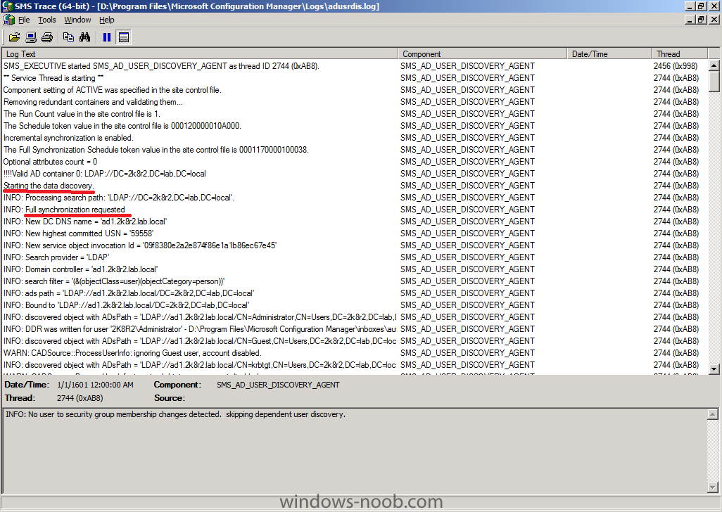

Using logs to verify discovery
In addtion to the visual verification we did above, you can browse the Logs folder of where you installed SCCM 2012, eg: D:\Program Files\Microsoft Configuration Manager\Logs
and find the following discovery logs
adforestdisc.log
adsgdis.log
adsysdis.log
adsysgrp.log
adusrdis.log
these log files can be opened with Trace64 and you'll see lots of interesting info in there such as starting the discovery and what type of discovery it is (the below sample screenshot is from the first discovery after enabling Active Directory User Discovery from adusrdis.log)

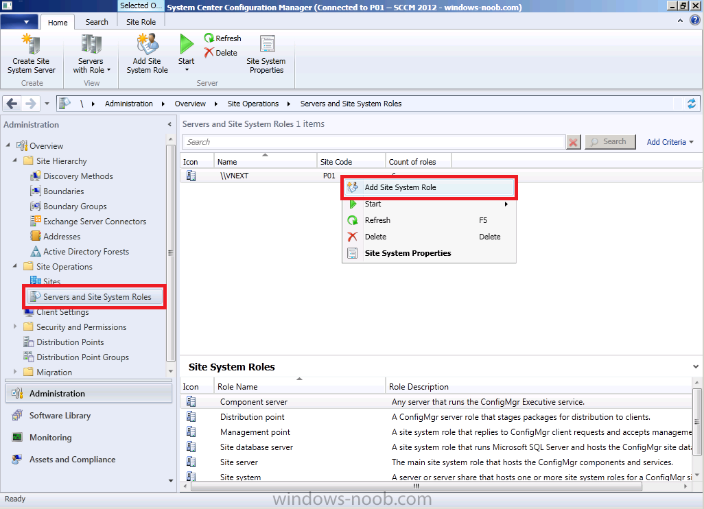

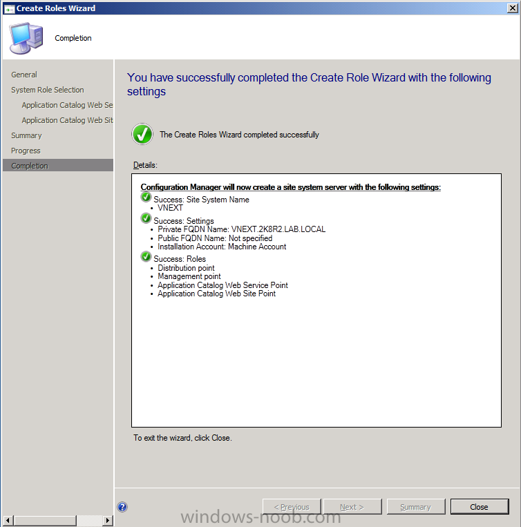

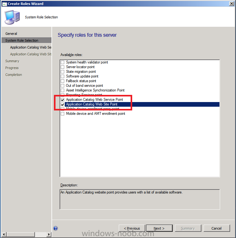

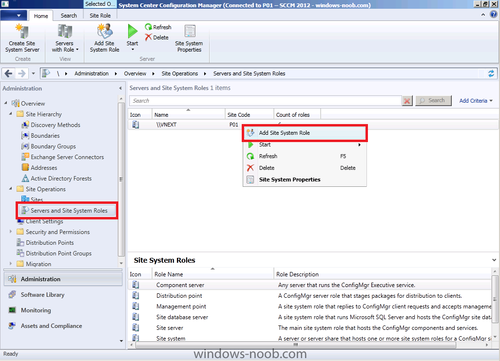

Step 4. Add the Catalog Web Service Point and Catalog Web Site Point roles
We will be setting some options in the next step which require certain roles to be installed, so in Administration, expand Site Operations, Servers and Site System Roles, right click on our site and choose Add site system role
create roles wizard appears, click next
select the following roles
  • Application Catalog Web Service Point
  • Application Catalog Web Site Point
and click next

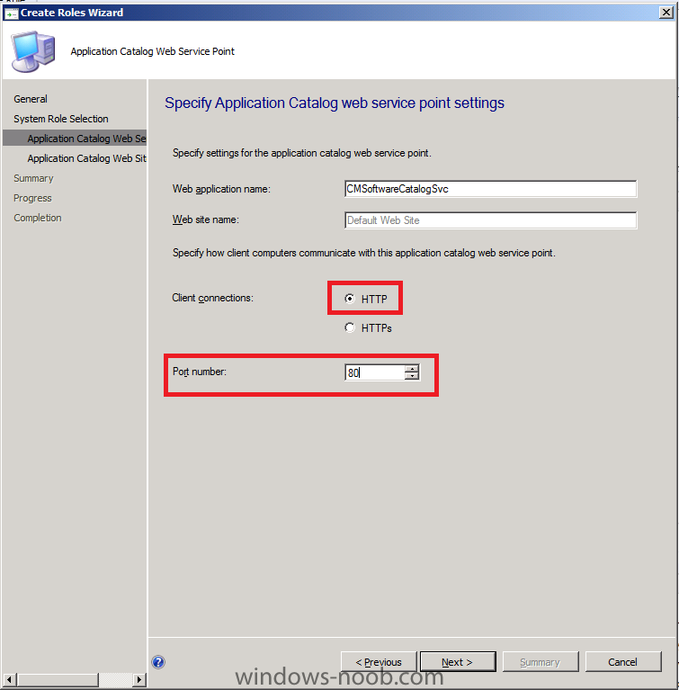

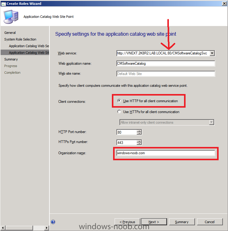

accept the following values for the application catalog web service point, make sure to manually change port 443 to port 80.
add your organization name to the application catalog web site point, verify it says port 80 and not 443
click next at the summary and review the completion

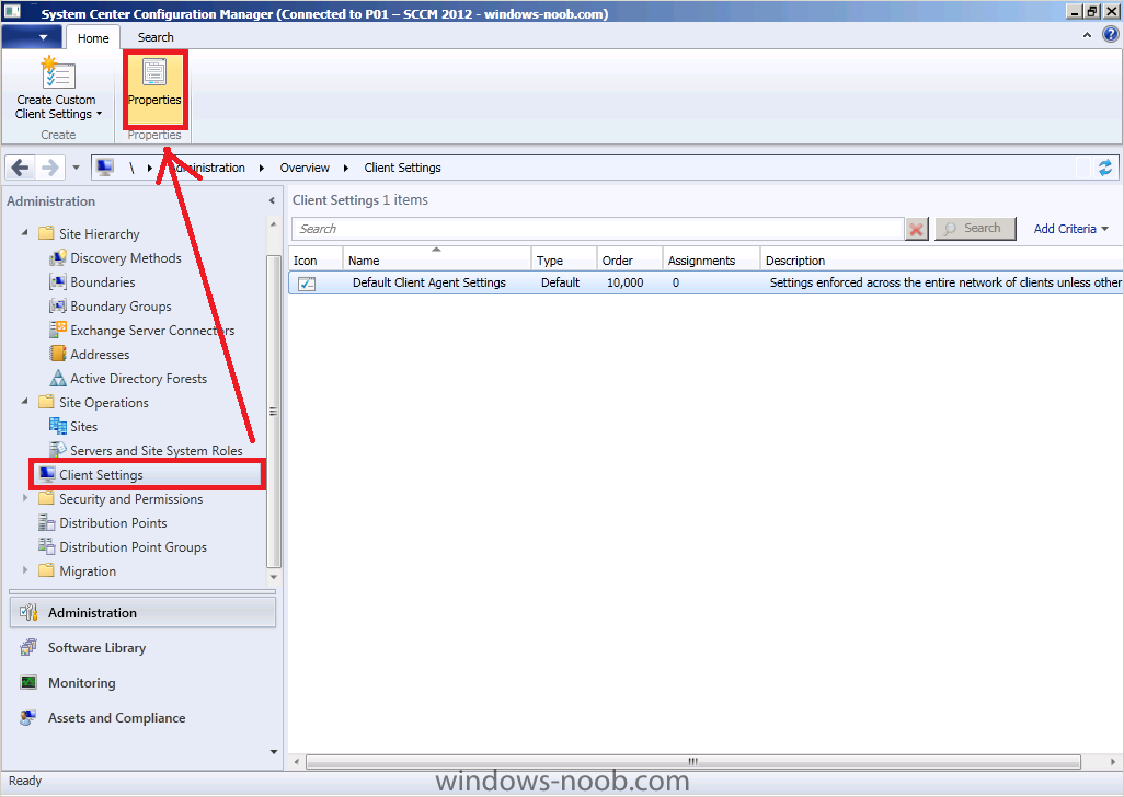

Step 5. Configure the Client Agent

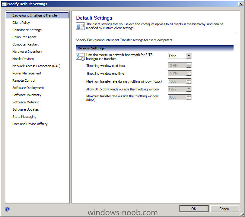

In the navigation pane, select Administration, then click Client Settings, select Properties from the ribbon. Currently there is only one client agent setting available – Default Client Agent Settings.
the Default settings appear

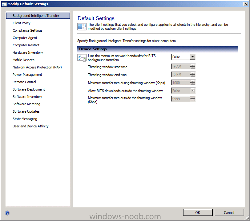

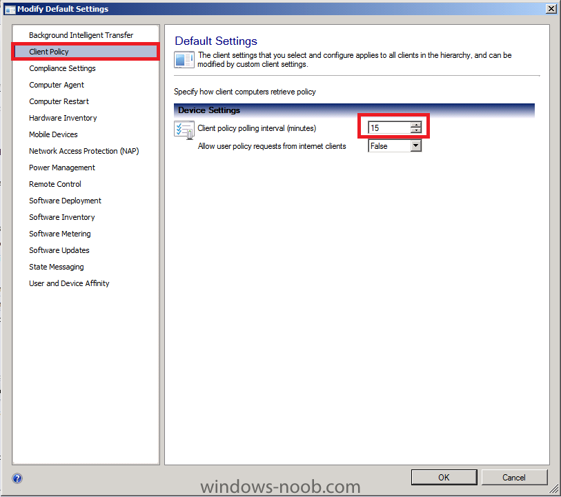

to start off with, let's configure the client Policy polling interval, select Client Policy in the left pane and change the value from 60 minutes (default) to 15 minutes as this is a LAB and we want our client to poll for changes in policy every 15 minutes.

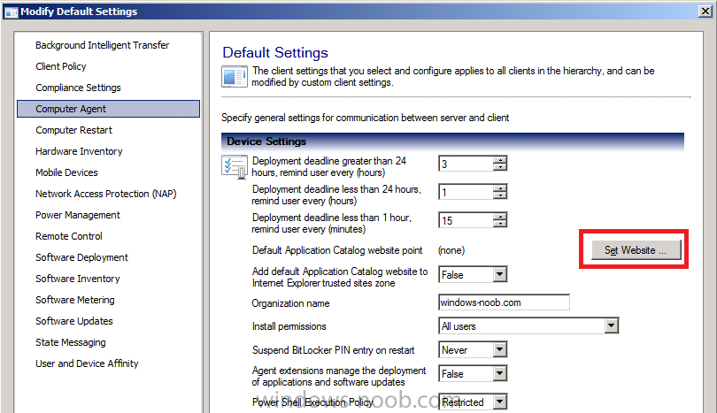

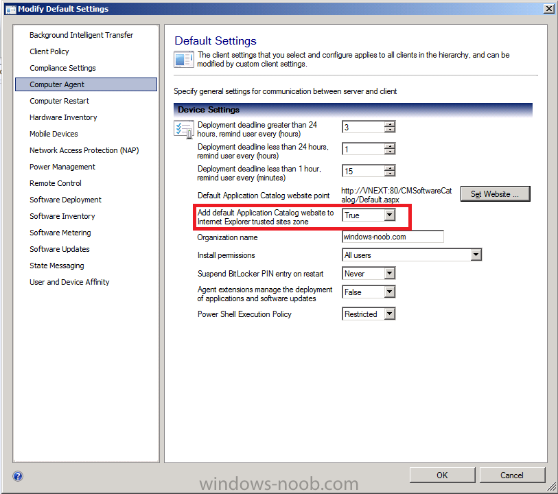

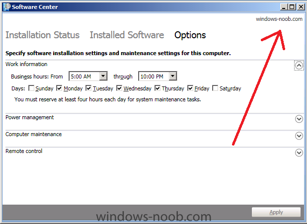

To change the Organization Name listed in the client agent, select Computer Agent in the left and type in your organization name

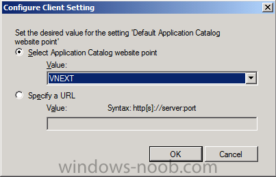

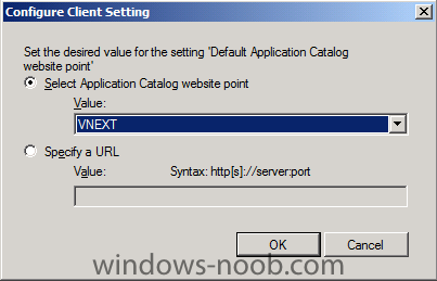

to the right of Default Application Catalog website point, click on Set Website...
select our VNEXT server from the drop down menu
change Add default application catalog website to Internet Explorer trusted sites zone to True

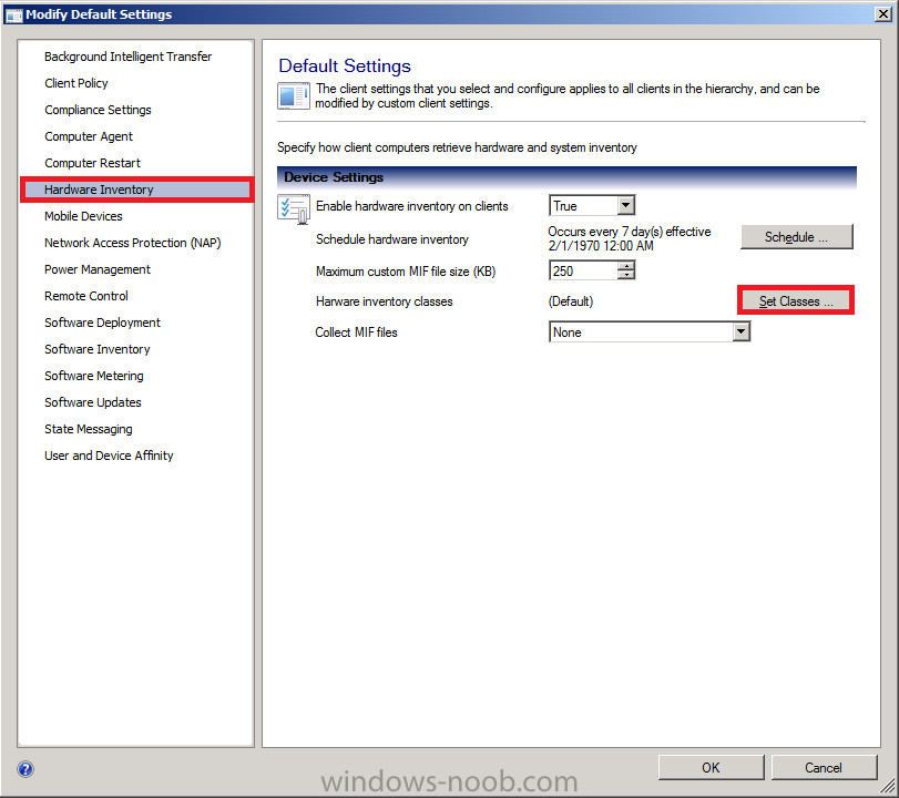

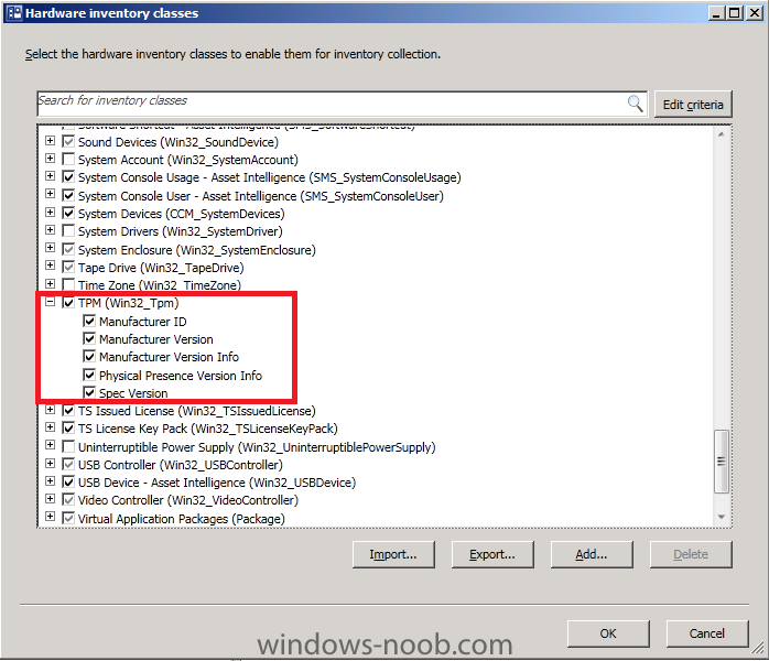

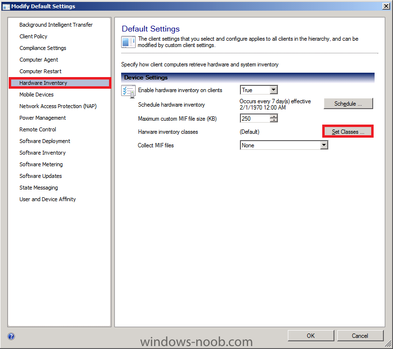

Now select Hardware Inventory on the left and then click on Set Classes
select TPM from the list of available classes, this will be a class that is reported on in the site's sms_def.mof

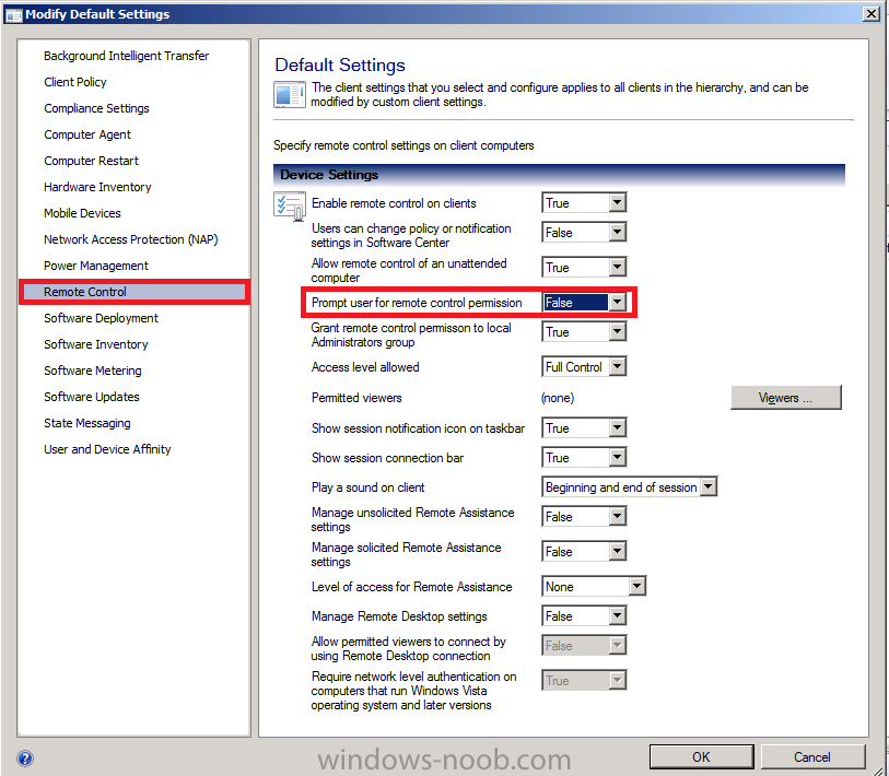

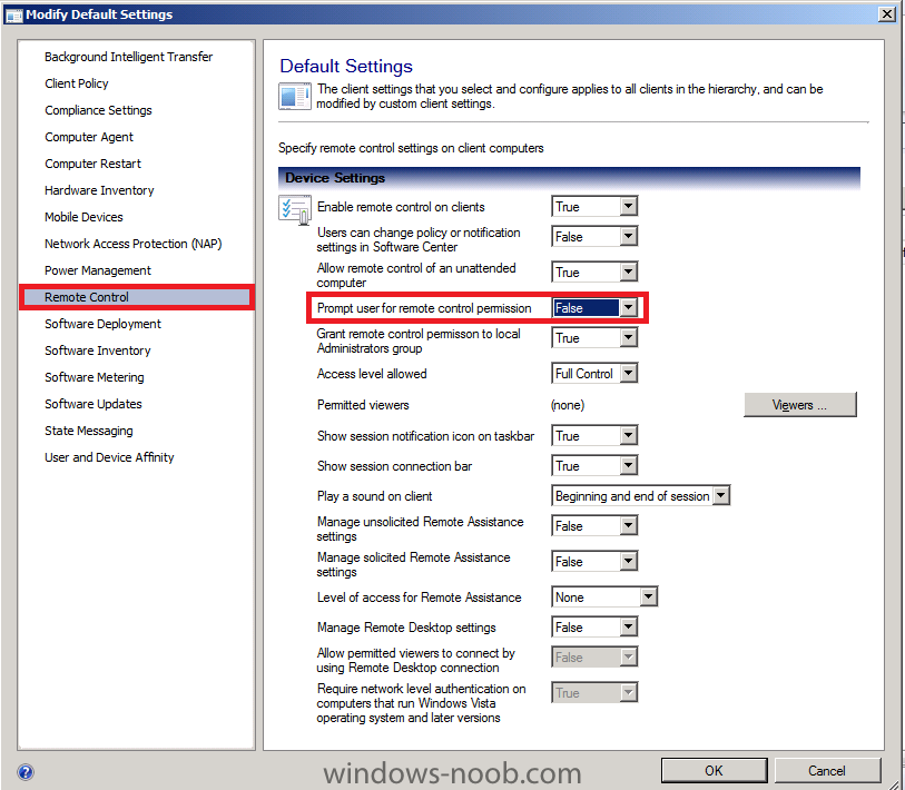

Now click on Remote Control in the left and set prompt user for remote control permission to false (useful when you want to remote to a Server)

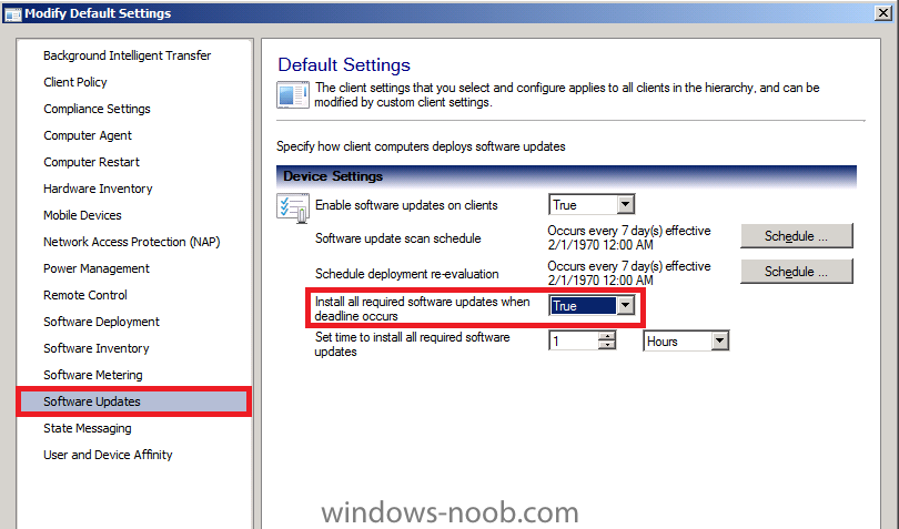

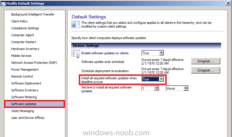

Select Software Updates and set the Install all required software updates when deadline occurs to True
click ok to exit from modifying default settings.

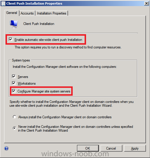

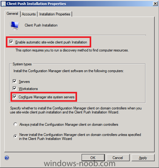

Step 6. Enable Client Push Installation

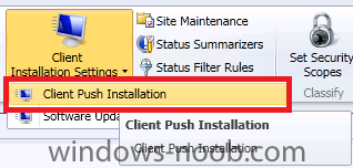

In Administration, expand Site Operations, Sites, select our site P01, choose Client Installation Settings in the Ribbon.
select Client Push Installation from the drop down menu
make sure that enable automatic site-wide client push installation and the Configuration Manager site system servers options are selected

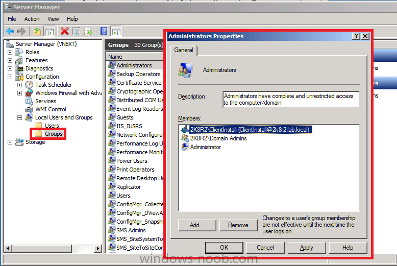

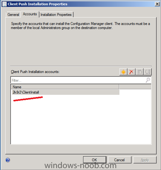

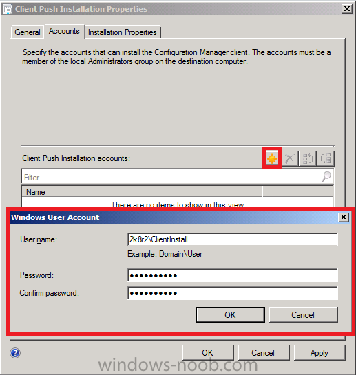

click on the Accounts tab and click on the yellow starburst, enter the user details of your ClientInstall account
this user must be in the local adminstrators group on your destination computers
click Ok

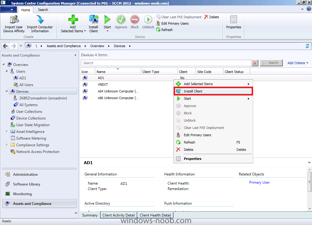

Step 7. Manually installing the client using the wizard
In Assets and Compliance select our Domain Controller (AD1) right click and choose Install Client

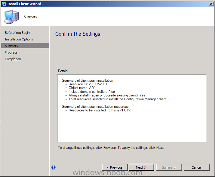

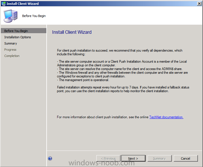

when the Install Client Wizard appears click Next
select the first two options (allow the client software to be installed on domain controllers and Always install the client software) as we only have one site currently (P01)
review the summary

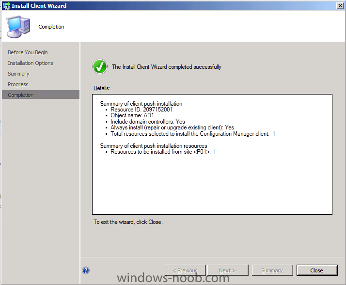

and completion

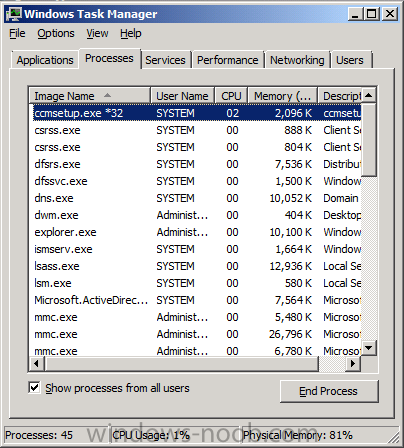

On the AD1 computer, you can open Task Manager and verify that Ccmsetup.exe is running, this means your Client software is installing.

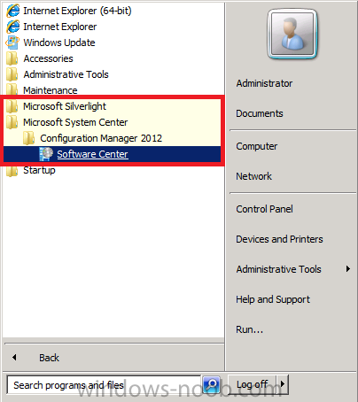

and you'll see new software installed in your start menu, including Microsoft Silverlight and Microsoft System Center Configuration Manager 2012 Software Center
and you can start Software Center and you'll see the IT Organization we configured earlier listed in the Top Right corner

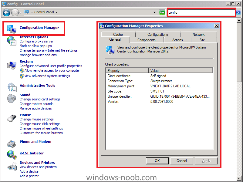

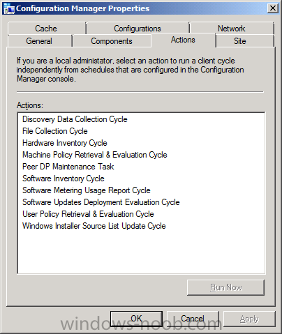

and finally you can view the client agent itself by opening up control panel, search for Config, and you'll see the Configuration Manager Client, click on it
Hello,
When you say install client on AD1 (which is a domain controller) and, I see you have successfully installed the client. In my case, I am unable to install the client because clientinstall (user) is not a member of Local Administrators group (which is one of the requirement to install the software as per your description).
On the Domain Controller there is no option to add clientinstall (user) to Local Administrators. Can you help me here how to proceed with.
I just started SCCM2012 install and, I am new to this subject.
Thanks
Ram
P.S: Ignore the message - Found a way to complete the client install.
