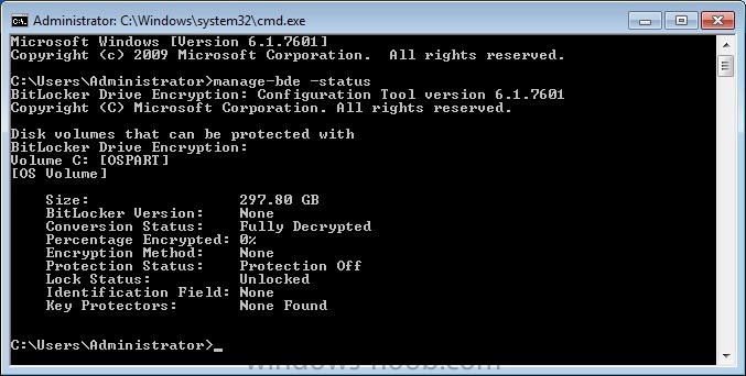

and you can open a command prompt and type manage-bde -status
