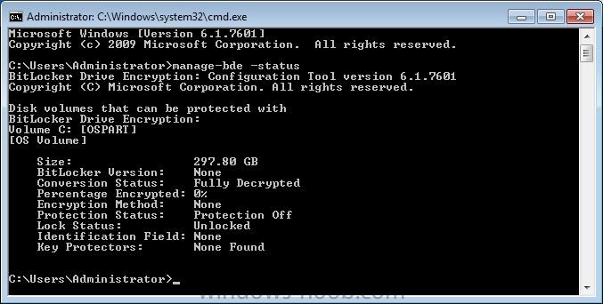

and you can open a command prompt and type manage-bde -status
after a few hours when the encryption process is done you'll see as follows (screenshot from another system where BitLocker has finished encrypting the drive)
