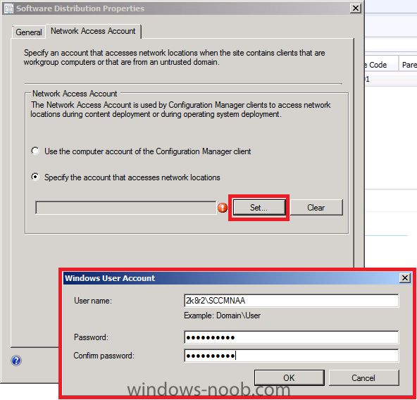

Now we will configure the Network Access Account because it is needed during the Build and Capture task sequence to access network resources (the Local System Account won't have access to these network resources and if you have not configured your Network Access Account you'll see Authentication failure 401 error messages in your SMSTS.log file).

Step 1. Configure the Network Access Account
Perform the following on our vNext server as SMSADMIN.

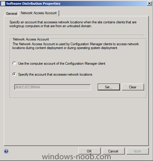

In the ConfigMgr console, select Site Operations, Sites and right click on our P01 site, choose Software Distribution (alternatively in the ribbon click on Configure Site Components, Software Distribution)
when the Software Distribution window appears, click on the Network Access Account tab, and input your Network access account credentials, we will use the user called SCCMNAA which we created in Part 1 of this series.
click Apply

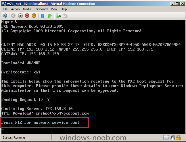

Press F12 when prompted

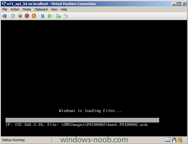

the PXE boot process begins, windows is loading files...

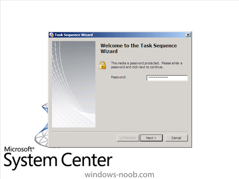

we get prompted for the PXE password

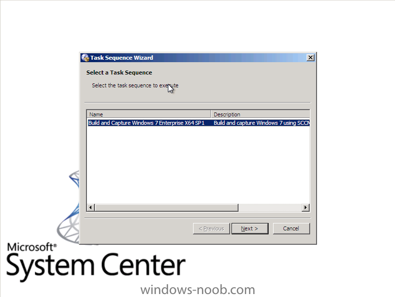

click next, and the list of available task sequences appears
select our previously created Build and capture task sequence and click next

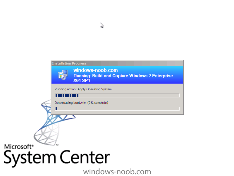

after partitioning and formatting the disc, the apply operating system step begins...

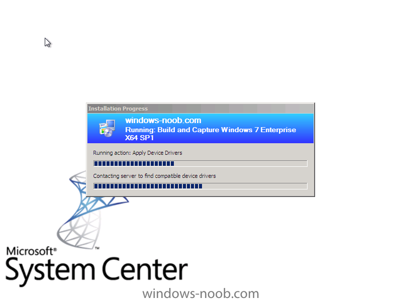

Apply Windows Settings, Apply Network Settings, Apply Device Drivers...

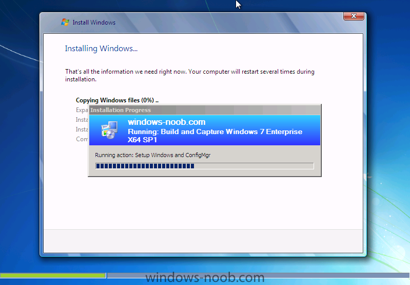

and it starts to Setup Windows

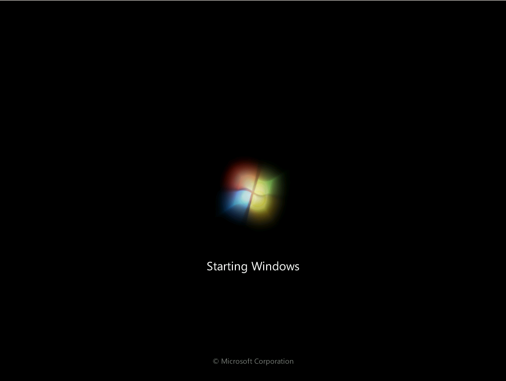

the next step involves rebooting the computer

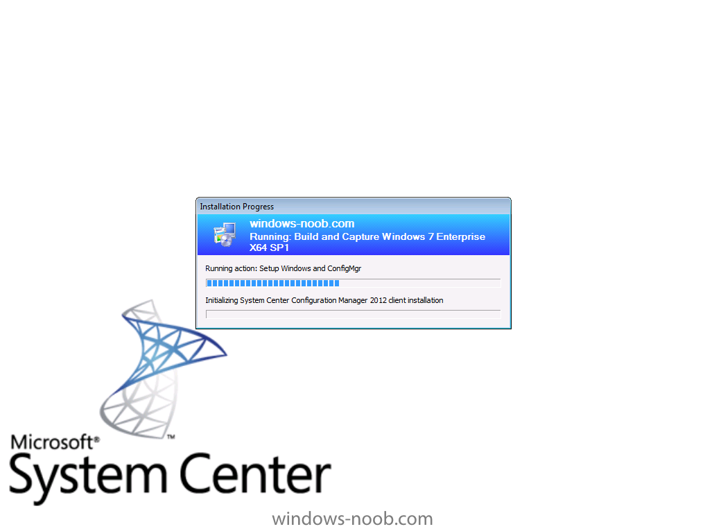

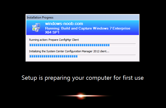

which allows Windows setup to continue (adding drivers etc) before another reboot...and then setting up the Configmgr client,

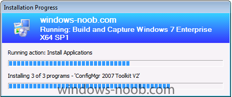

followed by installing updates and then applications

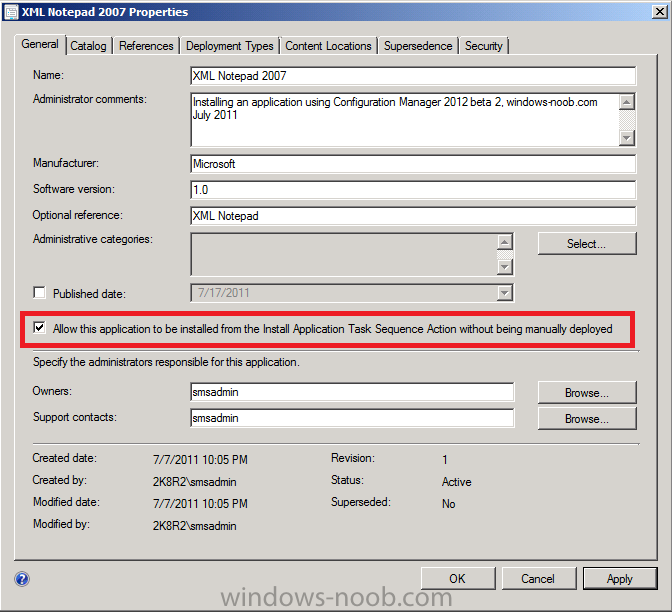

TIP: If your applciations are not installing check the following setting in your application allow this application to be installed from the Install Application Task Sequence Action without being manually deployed
allow this application to be installed from the Install Application Task Sequence Action without being manually deployed.png
We have not created any Update deployments so nothing will happen in the Install Updates step (we'll come back to that later in this series).

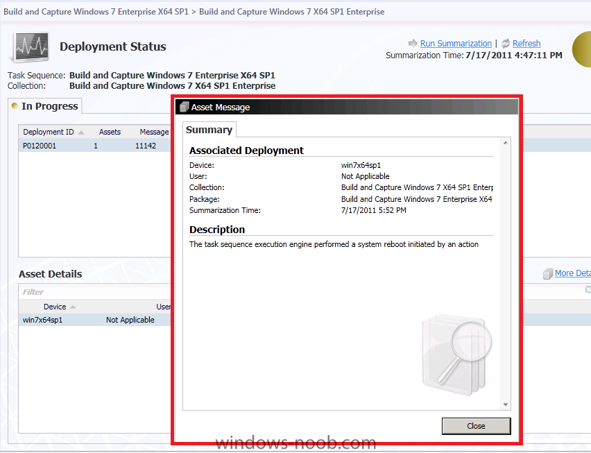

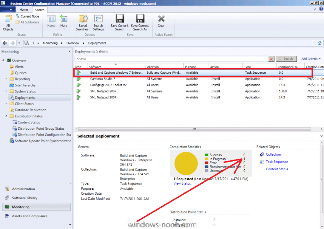

Tip: while you are waiting you can click on Monitoring, Deployments, select our Build and Capture Task Sequence to see an overview of the Deployment in process,
click on View Status followed by More Details to get more info about what is happening
Meanwhile, the task sequence continues by Initializing the Configuration Manager 2012 client *slow*
before doing the Prepare OS step

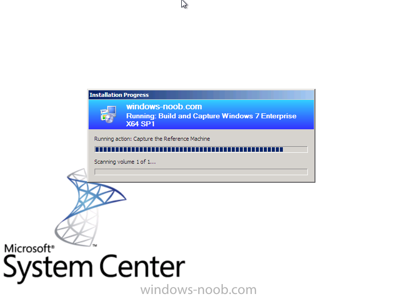

if you entered your capture account correctly in the task sequence, then it'll start scanning volume one of one

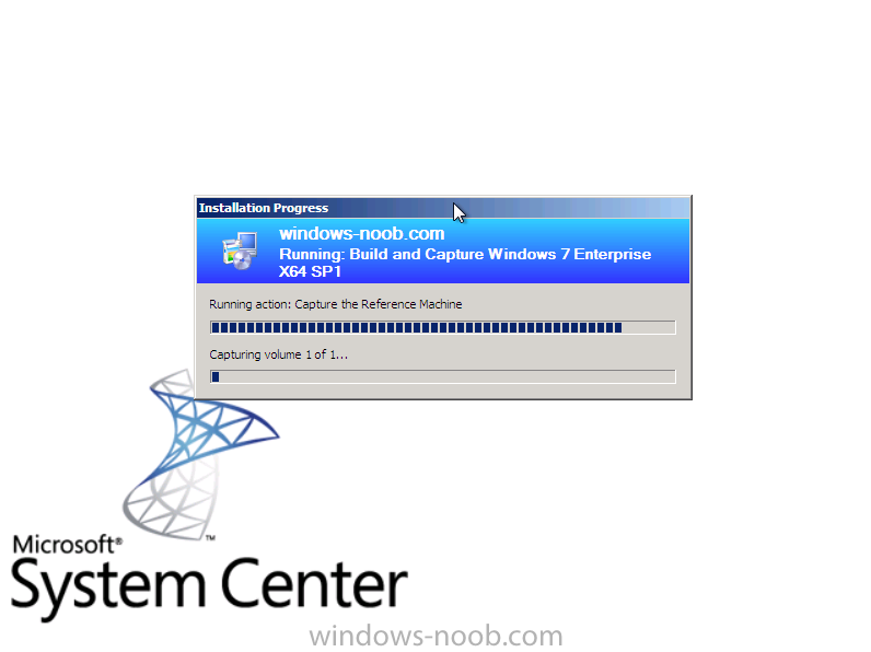

followed by the Capture itself, in the next part of this series, we'll deploy this captured image to another Virtual Machine.
