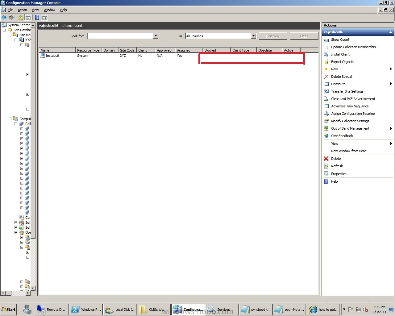

there is only one machine with the name testabc6 after adding the rule and also there is no value for obsolute colum attaching scrrenshot for reference.
FYI... OSD worked for two machines earlier al of a sudden I am facing this issue.
