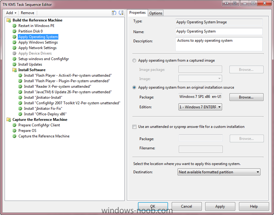

- Hyper-V (Hosted on Win08R2) VM - Kept all defaults except for adjusting HDD size to 40g & 1g RAM. Booted to ISO created by SCCM
- Lenovo m91p, Lenovo m60p, HP dc5700
Initial B&C Task Sequence
- Partition & Quick Format (NTFS)
- Applied Win7 x86 ENT
- No Product Key / Entered Local Admin Password
- WORKGROUP "Joined"
- Device Drivers Step (Disabled)
- Chose ConfigMGR Package with below String
MSCACHESIZE=8000
SMSSLP=TNSCCM01.pens.com
SMSMP=TNSCCM01.pens.com
FSP=TNSCCM01.pens.com
PATCH="%_SMSTSMDataPath%\OSD\PEN00009\i386\hotfix\KB2509007\sccm2007ac-sp2-kb2509007-x86-enu.msp"
- Installed 8 software packages (All proven to deploy in past)
- Capture to known good share
Variables I've Changed in above TS to try to get to work
- Enabled Device Drivers step (All Drivers)
- Exported all non-original windows drivers from Win7 Hyper-v VM and made the Device Driver stpe use only them
- Changed ConfigMGR string to point to different server with same roles
- Advertised both as "Fetch as needed" and "Download all first"
- Ran all variations on different platforms listed above.
