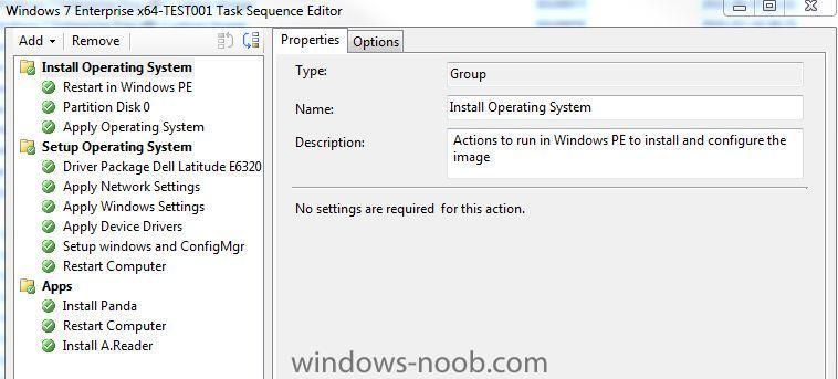

I have a working 32-bit OSD.
But now we have started with 64-bit installations and i have created a TS for this. I have followed the guide to create the .wim file.
My TS looks like this:
And when i follow the TS it runs trough, no problems to be seen. It says that it complete all steps, install the software, install the sccm client, joins the domain, set the local administrator password.
But when the TS is complete and the computer boots up, no software are installed, the computer is not in the domain. But the local administrator password is set so i can logon as the local administrator.
So it seems that it's something wrong with the network? due to all the steps that runs OK but dont happen has something to do with network access. I have downloaded the NIC driver again and imported it, i have tried with Auto apply drivers and Apply driver package for that computer model.
Anyone got any ideas? Any log that i can give you guys or that i can look in? Im completly lost with this one.

I have the computer next to me that i try to run the TS on, and i look at it and i can see all the steps running, Apply Network settings, Install Panda etc.
And also i check under Site Status -> Status Message Queries -> All Status Messages and follow the TS, and here i see the steps. Completing with the Exit code 0:
Here is my Apply Network Settings;
The task sequence execution engine successfully completed the action (Apply Network Settings) in the group (Setup Operating System) with exit code 0

usually always means you don't have a valid ip address or incorrect or missing network driver, so press F8 during that process and verify that you have network connectivity after the apply driver package step
I just did that, after the Apply Driver Package i have a correct IP and i can ping servers. Then the computer restarts and start with the step "Setup windows and ConfigMgr" and now i press F8 again and have no ip-adress.. i really find this strange!
I know this is an old post, but just for future reference.
If you don't get an IP in the WinPE phase, you need to inject drivers in your boot image.
This is possible from within SCCM.
Don't forget to update the Distribution Points.
If you don't get an IP after applying the new Windows Image, no suitable drivers were found in the Apply Driver Package step.
You can fiddle around a little with the settings in the "Apply Device Drivers" step.
Check "Install ALL compatible driver" and "Consider drivers from all categories".
Worst case scenario would be injecting the drivers in your Windows 7 image, but this might cause driver issues when you install this image on other devices.
If you 'trust' your drivers, you might also want to check "Do unattended installation of unsigned drivers on versions of Windows where this is allowed".
Some domain setting might cause the fact you don't get an IP.
You can consider making an IP reservation for the device.
