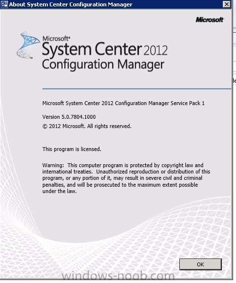

I have installed SC 2012 SP1 + SQL Server 2012 CU2e

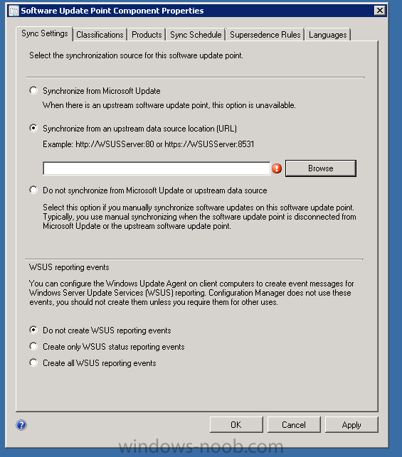

Now I am having trouble syncing updates in sccm with going straight to microsoft.
UPDATE:
WSUS in iis uses 8350,
Does WSUS need to be on the default website to work? Or no.
Everything appears to be syncing now...
But it is going to take around 4 days 10 hours : 40Min : 45 sec (last time I checked) to complete according to the wsyncmgr.log
Can I cancel and select less products? Can I select less products while it is syncing?
We are running SCCM 2012 R2 in a offline closed network. We have another SCCM 2012 R2 server that is online that we use to get updates from Microsoft. We export the patches from out online machines to our offline machine and then patch our offline network. We just recently discovered that we have a problem with getting all of our updates. I get the feeling that the product list is not being updated on our offline machine and that it is missing MS Server 2012 R2. I say that because on our online machine we can see that there are patches for MS Server 2012 R2 for MS14-029, but our offline machine is missing the MS Server 2012 R2 patches. So my questions are 1) Is there a way to see the product list in the SUP and 2) How do I update the product list in the SUP?
