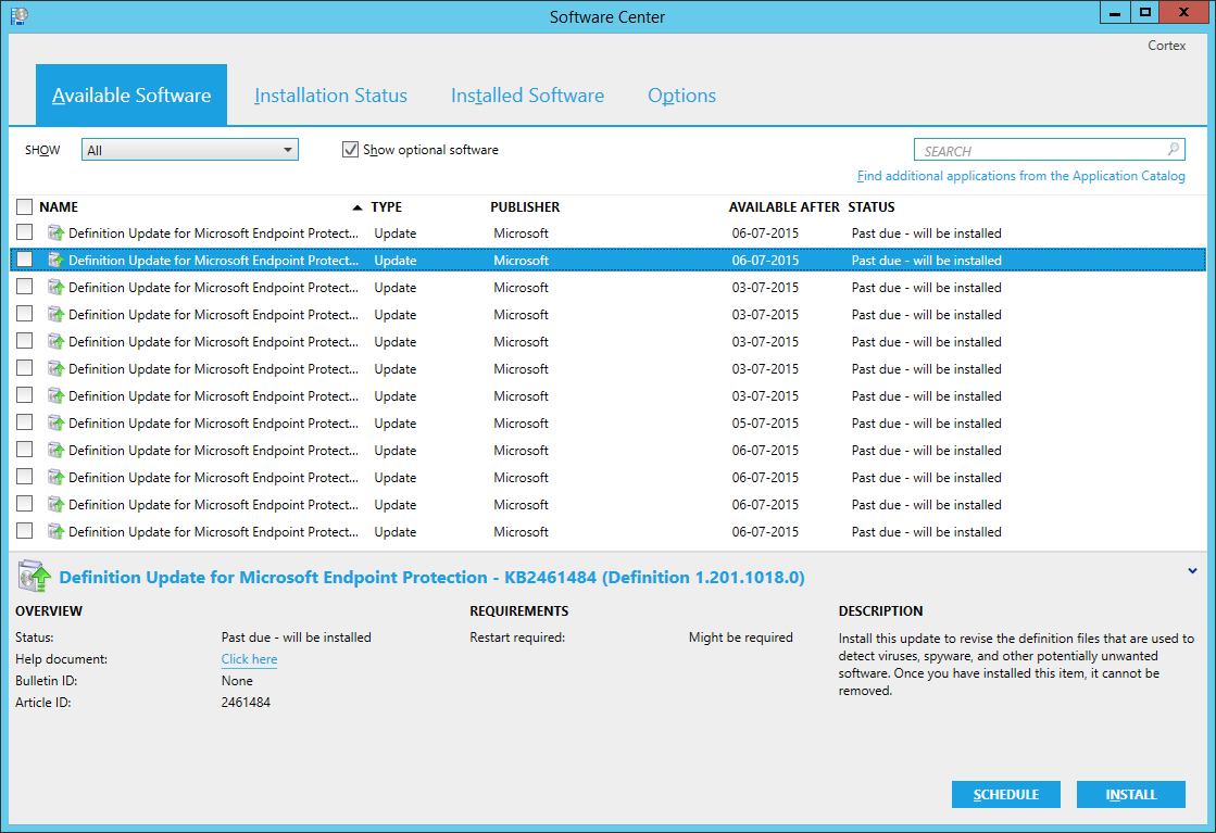

that's only the index of updates, ie: whats available, so unless you downloaded everything you've nothing to be concerned about
if you want to verify that look at whether each update is downloaded or not,
also, to sort the updates use the Search ability and add criteria, for example type in definition updates in the search field and click search
