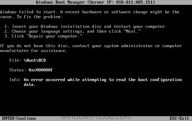

Secondly, I need help as I am getting the exact same error as amvsnorc, namely:
I have been stuck on this for the past few days now and ready to pull my hair out. I've tried recreating the task sequence, the client package, etc. I've tried re-deploying. I've tried stop/starting the WDS service, DHCP service, the server itself, but I still keep getting the same error.
Please can somebody help!!
this error usually means it's already passed the PXE section and has got as far as trying to boot from the hard disc but cannot as there aren't any boot files on the disc yet...
so reboot and verify if you are indeed seeing any PXE related messages, if so what do they say

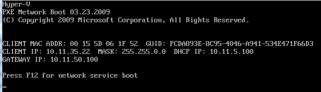

I'm running SCCM 2012 RTM. Going well so far apart from this big that I cannot seem to solve. I've followed all steps in part 7 of this guide and this is what I get....
So I press F12, but then I get this...
My DHCP server is on a different server than my SCCM server, these are both on the same subnet. My client is on a seperate subnet to the servers. I've had PXE boot working fine using standard WDS with MDT, but just can't get this working... heres my DHCP options...
Any help would be great!!!
