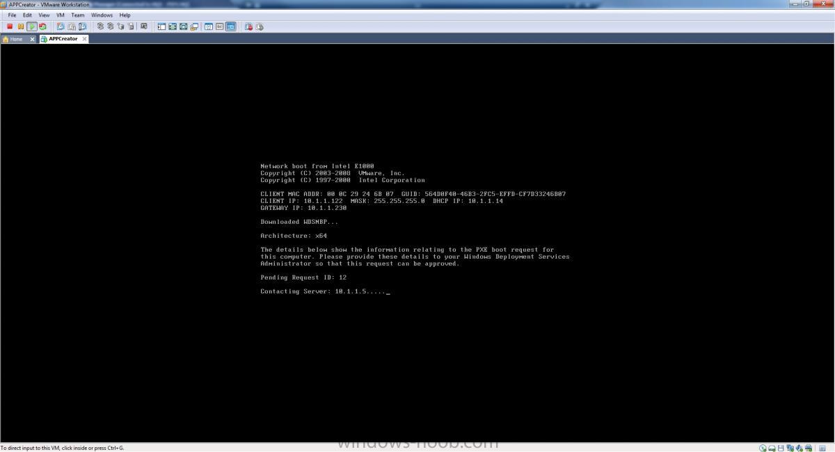

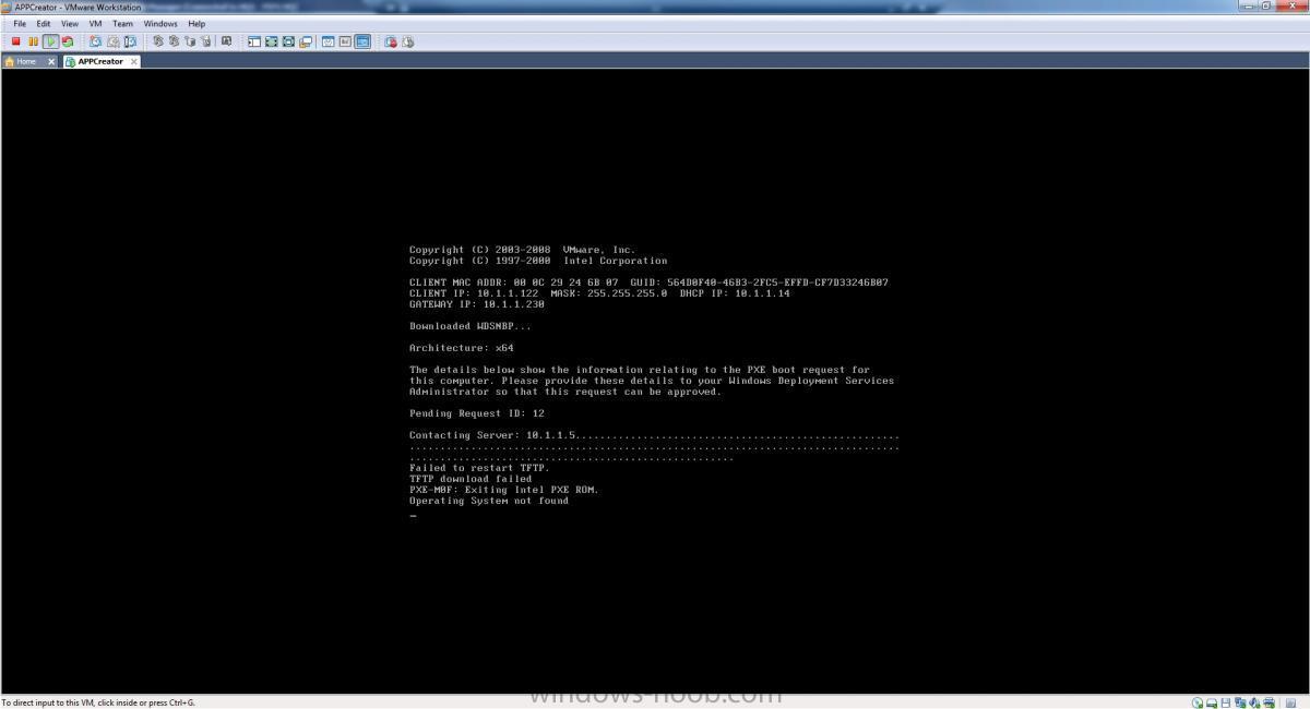

HI administrator,
thank you so much for your guides been a great help!! i'am just having issues with PXE please see attachment, just not sure what is causing this if you could point me in the right direction will be a great help.
thank you so much
