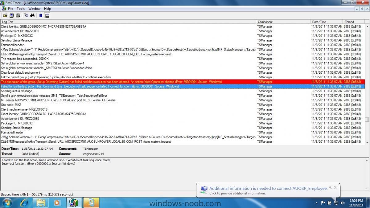

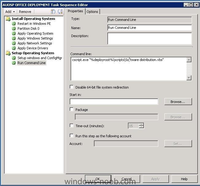

Recently i'm doing some scripting to create the run advertised program shortcut at start menu. The vb script is successfully tested on window 7 environemt. I planning to put it on OSD inside TS but getting the command line TS error as per attached.post-12216-0-88221400-1320735606_thumb.jpgpost-12216-0-89072000-1320735621_thumb.jpg
I will appriciate if someone can let me know what I am doing wrong.

I'd just put the .VBS file in a folder, and then make that into a Package just like you would any other application. Then your Command Line is just the name of the .VBS file. And then you can add it into the TS just as if it were an application...
