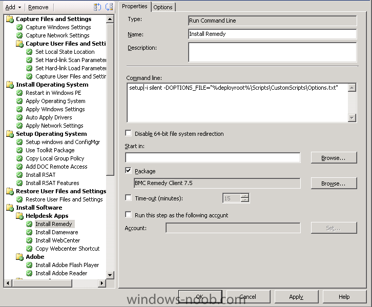

Having trouble installing an app via OSD TS
I am trying to install an app via OSD TS and having trouble. The command line works manually. Below is the error I'm getting and a description of the TS.
The task sequence execution engine failed executing the action (Install Remedy) in the group (Helpdesk Apps) with the error code 2147942402
Action output: 80070002 (e:\nts_sms_fre\sms\framework\core\ccmcore\commandline.cpp,997)
clCommandLine.Execute( uOptions, pszWorkingDir, lpDesktop ), HRESULT=80070002 (e:\nts_sms_fre\sms\client\osdeployment\installsoftware\runcommandline.cpp,558)
Entering ReleaseSource() for C:\_SMSTaskSequence\Packages\CR200091
reference count 1 for the source C:\_SMSTaskSequence\Packages\CR200091 before releasing
Delete source directory C:\_SMSTaskSequence\Packages\CR200091
Released the resolved source C:\_SMSTaskSequence\Packages\CR200091
cmd.Execute(pszPkgID, sProgramName, dwCmdLineExitCode), HRESULT=80070002 (e:\nts_sms_fre\sms\client\osdeployment\installsoftware\main.cpp,385)
CreateProcess failed. Code(0x80070002)
Command line execution failed (80070002)
Failed to executecommand line 'setup -i silent -DOPTIONS_FILE="C:\_SMSTaskSequence\WDPackage\Scripts\CustomScripts\Options.txt"' .
The system cannot find the file specified. (Error: 80070002; Source: Windows)
Install Software failed to run command line, hr=0x80070002. The operating system reported error 2147942402: The system cannot find the file specified.
I can clearly see what the problem (in red) is but I'm not sure why it's happening. TS is setup as run command line because it seems like the "options" file needs to have an absolute path to work properly. The first time I tried running it manually I placed the "options" file in the same folder as the setup.cmd but I still had to add the entire path in order for it to work. I have this same setup to install Cisco iron port and that works perfectly. I've updated my MDT toolkit package to make sure the custom scripts folder is up to date. BMC Remedy Client 7.5 package is just source files, no program.
Quick side note: the setup file is a setup.cmd file that passes some arguments on to a setup.exe in a different folder. The app does not install properly if you don't launch it using the setup.cmd
I followed the below steps on cretaing a silent install and it works manually but I can't seem to apply it to an SCCM ts.

Have you tried packaging up the thing and installing it as software and not a Run Command Line item? And if you're having problems, then maybe post the code you're using in the .CMD file. Ususally the culprit is the path(s) being used in the script...
I have tried it both ways. When I did it as "install Software" I tried using the install.bat method taken from what I posted above, Same results. I changed the command line the from just "setup" to "setup.cmd" and it seems to partially install the app now. However based on some testing i've done manually the patrtial install points to it not being able to read the "Options.txt" file. Is there a way to provide an absolute path other than deployroot? Although I have that same method working for 2 other TS and they work fine. Below is the contents of the the setup.cmd file. This is not written by me, it is the normal installer for this application.

Thanks Lucid. Never apologize for trying to help. I appreciate it very much. I will try it out and let you know what happens
  On 11/11/2011 at 7:20 PM, Peter33 said:
the Setup.exe should be an Install Shiled Insataller. You can create a response file for a silent installation with the command line "setup.exe -r -f1".\setup.iss". With the response file you can create a simple program in the SCCM package "setup.exe -s". With the -s switch the setup will look for the setup.iss and run completely unattended. Just make sure you capture the iss file on a clean machine without any previous installations of your Remedy Client. This way you can avoid all the hassle of batch files and option files (which are place in the MDT script folder?).
Not sure if it matters or not but the setup.exe is installanywhere. The options.txt is taken from an ini file in the installation folder.
Well, it matters. But not that much. The syntax is just slightly different. Look here.
I am still thinking that the problem is caused by the %deployroot% variable. If the options txt is placed in the package folder just replace the path by ".\Scripts\CustomScripts\Options.txt".
Thanks for all the help. I've finally resolved the issue. Thanks to the install anywhere link you sent I decided to create a response file using the -r switch. Once I had that I used the following command "setup.exe -i silent -f %deployroot%\Scripts\CustomScripts\options.properties". Works like a charm.
Sorry to revive an old thread, but I found this on Google and have been troubleshooting this for a few days now. I found a solution to the original problem and wanted to share in case someone else stumbles upon this in the future. When installing the Remedy via SCCM (2012 SP1 in my case), there are 2 things that are important.
  1. The working directory has to be the folder ABOVE the Disk1 folder. Remedy requires the folder be called Disk1 and since SCCM copies the files to a cache, that link will break unless we copy up the entire Disk1 folder.
  2. The Options.txt file has to be the full path even if the file is in the working directory.
I created an application with the contents contained in
\\Server_Name\Folder_Name\
and ran the install command
Disk1\setup.cmd -i silent -DOPTIONS_FILE="\\Server_Name\Folder_Name\Disk1\Options.txt"
*Technically this will still fail because the detection method kicks off write after the setup.cmd script runs, but if you wait until the install finishes look in the Program Files or Start Menu, it is installed successfully.
