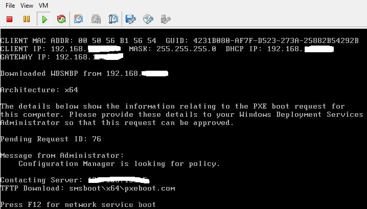

My virtual machine (WMvare) was PXE booted:

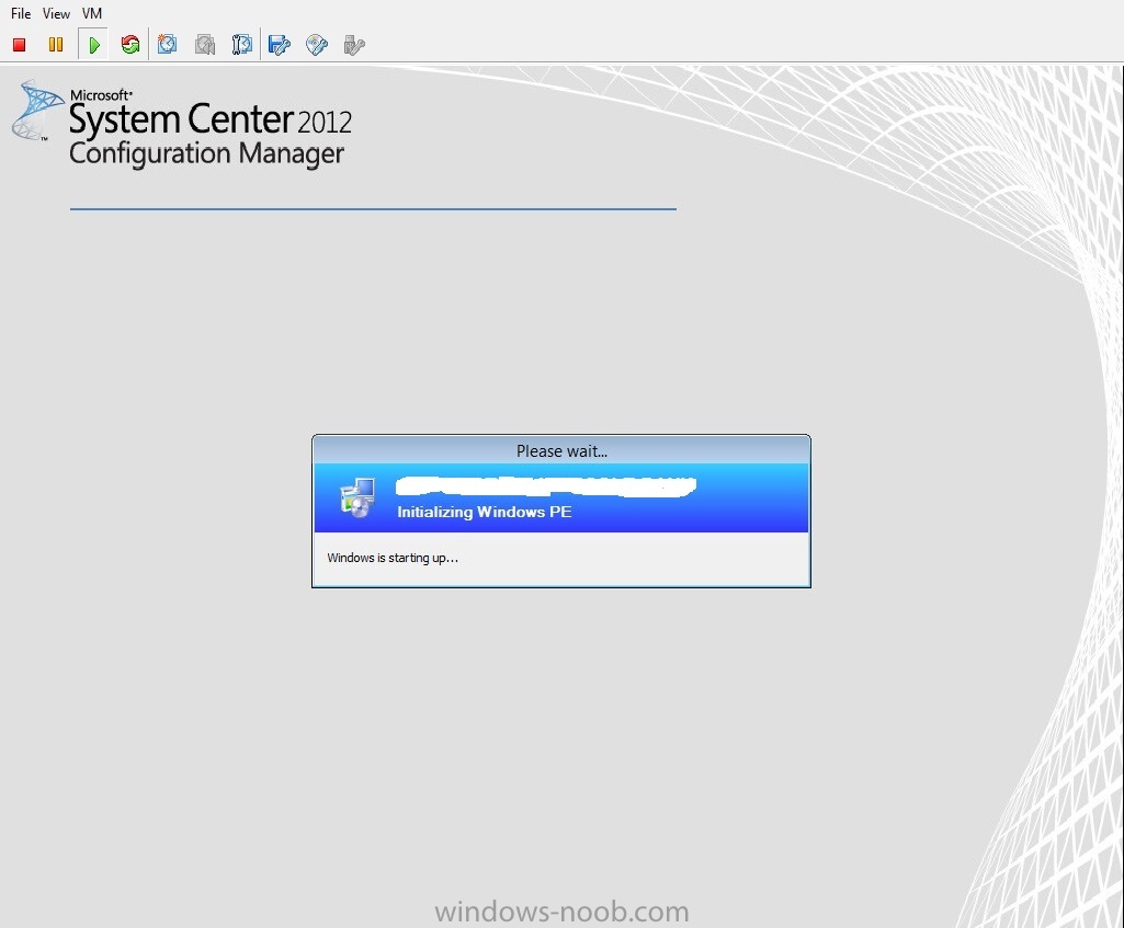

Then shows Initializing Windows PE :

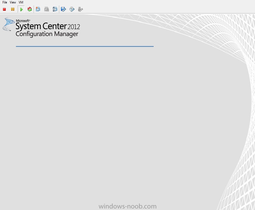

After that shows blank:

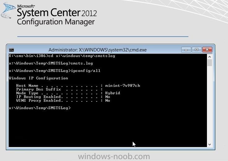

press f8 before it reboots and see if you have a valid ip address, also read the smsts.log in x:\windows\temp\smstslog
it'll reveal the problem

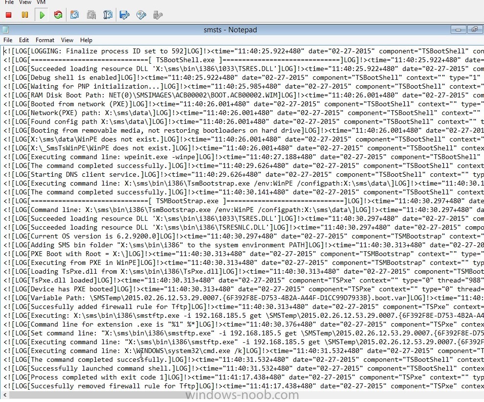

In smsts.log:
The execution of the group (Install Operating System) has failed and the execution has been aborted. An action failed.Operation aborted (Error: 80004004; Source: Windows)
Failed to run the last action: Apply Operating System. Execution of task sequence failed.Unspecified error (Error: 80004005; Source: Windows)

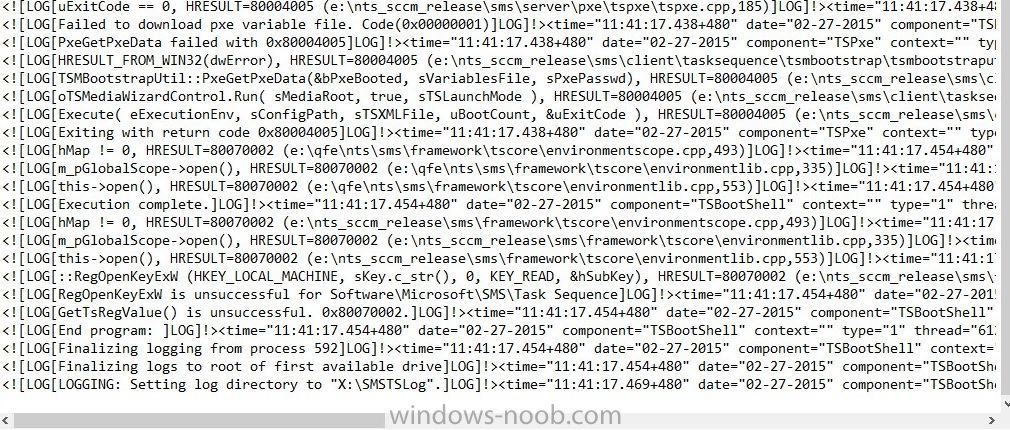

Hello,
Thanks for the awesome article. I am new to SCCM. We have newly built SCCM environment. I have installed agents on all the machine and they are communicating fine. We had MDT solution before under which we had several wim images ready to go. I am following your article step by step but not getting anywhere. First when i try to pxe boot my test machine I am getting "TFTP Download: smsboot\x64\abortpxe.com" "PXE Boot Aborted. Booting to next device". When i go to check my smspxe log, it is not even updating. It is stuck on red screenshot attached.
I have tried removing pxe and wds role, rebooted and re-added the roles, still not luck. I am stuck on this for a week now. Please assist. Thanks
