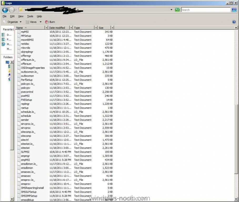

I have WDS installed on my sccm 2007 server and I have DNS on a seperate server as well as DHCP on a seperate server. My SCCM 2007 is installed well, with no issues from the status. I am having hard time setting up Deployment via PXE. Please help me. I have gone through your step by step instruction, but no luck. At first I had a Pending Request, Now, it can't even find the specified file. What should I do?

there is more than one LOGS folder, double check that you are looking in the right place, if in doubt use explorer to SEARCH your disc partitions for the file
