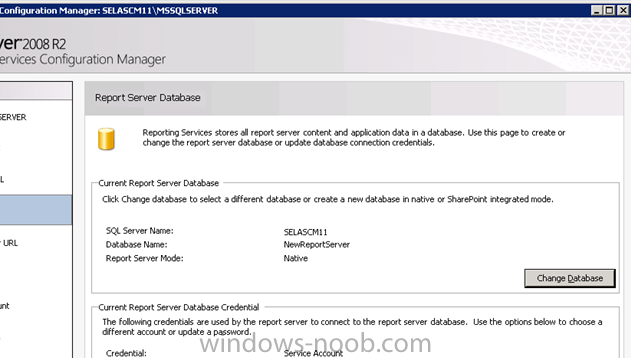

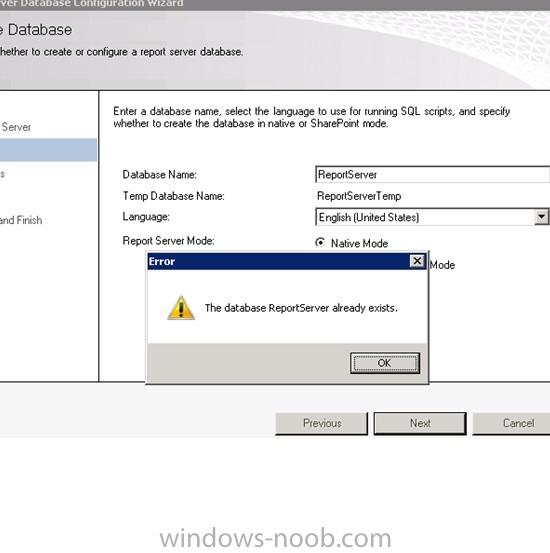

I'm having a bit of a nightmare with the reporting service. I first had it up and running but the report log size was going through the roof. So I uninstalled the reporting service from the sql server and removed the role from CM. I also deleted the “ReportServer” DB.
Now I have reinstalled the sql reporting service. I tried to create a “ReportServer” database, but I am getting an error that this already exists.
So I named it NewReportServer and have added the role to CM, but in component status the reporting point is critical.
Can anyone help?
Can anyone help?
I had the same problem. The problem was that reporting services was added AFTER SP1 was installed on the SQL. You need version 2500 of reporting services to be able to use it with SCCM 2012. Look at my picture and check the version you have.
If you have 1600 like the picture, you need to re-install SP1.
Just to clarify, this fixes the problem "The report server service is not running...." problem.

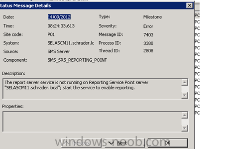

Our site (SCCM 2012) is using a single SCCM 2012 server that is using a remote SQL Server 2008 R2 with SP1 CU6 - 10.50.2811.0 with reporting services installed on default instance (mssqlserver). On the SQL box is also IIS with a default website in use.
From the SCCM 2012 server i can connect and browse to http://sql1/reports and http://sql1/reportserver
On my SCCM2012 i try to add the Reporting Services Point to the SQL server from the SCCM console, it succesfully finds the MSSQLSERVER instance on the remote SQL server but then encounter errors.
In Site Status during installation i see error below:
Meesage ID 7403 > The report server service is not running on Reporting Service Point server "SQL1.DOMAIN.COM"; start the service to enable reporting.
Looking on the SQL/REPORT SERVER We've verified the service is running and we can connect to the URL.
In the URL http://sql1/reports the folder name isn't there and is not being created.
In addition i CAN'T find a Log file SRSRP.LOG on my server Program Files\Microsoft Configuration Manager\Logs
I found many post with this 7403 error but my Report is CU6
Did you check my post above? check the version on the reporting services.
