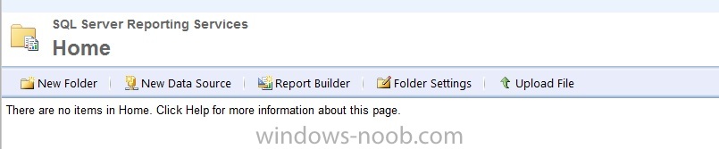

I having problem to configure the reporting service in SCCM 2012. After setup reporting service point in SCCM 2012, my report list still show empty and the configuration folder below does not create at my SQL report manager URL
I tried re-do this few step many times but none of it works. Hope that you can give me some idea why this happen, thanks.

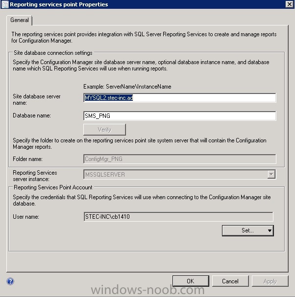

I'm Trying to install reporting services point SCCM 2012, I configured the site system role without problems, but when I tried to configure the report options I get this error:
"There is a problem connectiong to the specified reporting, please check the conection and make sure SQL Reporting Service is running on the especified server. "
The reporting service is running on remote server, I'm using SQL SERVER 2008 r2 Sp2.
When users are added or user rights are modified on the report folder by using Reporting Services Report Manager, Configuration Manager doesn't do nothing, if I use a new reporting instance with no user added, everything works OK, create security roles and add user to report folders.
firewall is turn off in both servers, the SSRS version is 10.50.4000.0
Any Idea?
I had to create a Report DB in SQL as it didnt seems to create it i then linked that in report services, problems i have is i open IE as admin then http://FQDN/reportsand get a 404 error, if i open FQDN/ReportServer it works and i can access it. Not sure if something in IIS is missing maybe?
