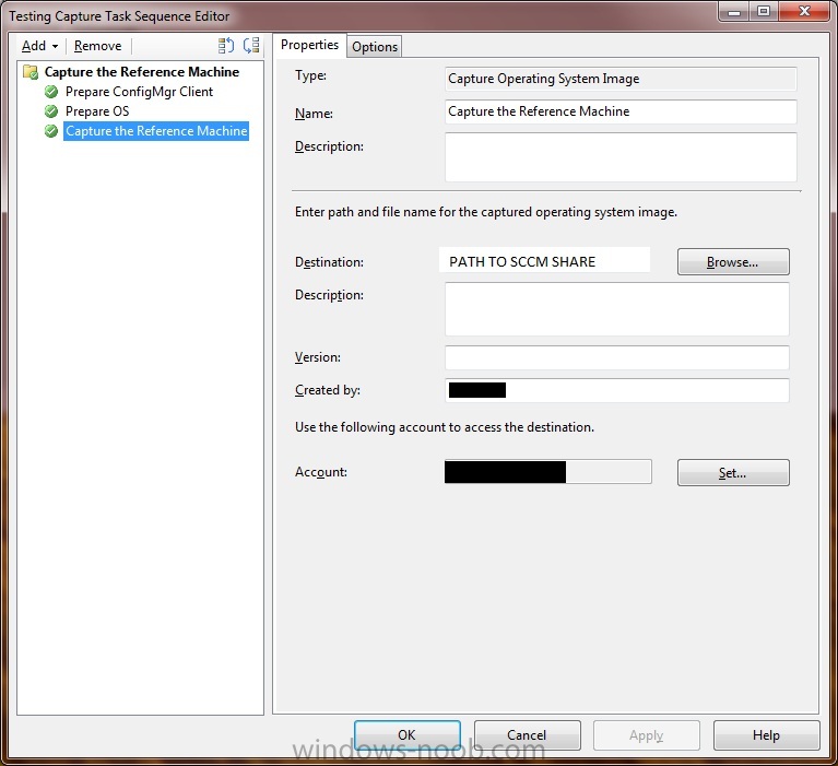

To all,
I have been reading through the other posts and still have some issues. I'm attempting to capture a reference Win7 x64 computer but keep getting error messages (0x00000032). I have attached a screenshot of my TS. I have attempted to run this from RAP but it just reboots into PE and fails. The real problem I have run into is that this WIM will only be deployed to non-domain machines so I don't want the reference machine to be or have ever been on the domain. I would greatly prefer to not use boot media other than PXE if at all possible.
Any help would be greatly appreciated.

So I've made some progress on this. I now have it able to run from Windows, go through the sysprep process and reboot but the TS reboots into PE and fails with error code 0x00000032. Is there a way to specify whether the TS should reboot into the full OS or PE? I have the smsts.log file copied over but I don't know how much good its going to be other than saying it needs to be run in the full OS.
@CorradoGuy, I have looked at doing imagex or some similar alternative. I still have a functional WDS server that I can use to capture the image but I would like to get everything integrated into SCCM if possible.
If you add a Restart line item in your TS you can tell it to either restart in the TS, or in the default installed operating system. If you don't want to use boot media, have you looked into creating a Build and Capture process that does things for you from start to finish?
