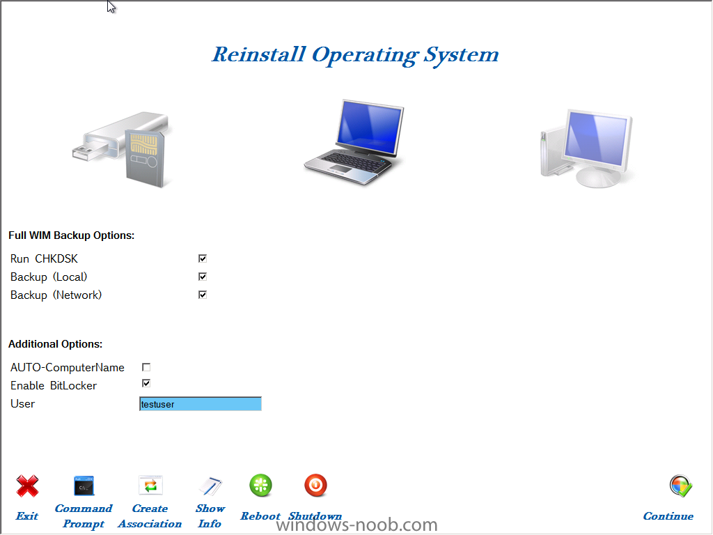

The Reinstall Computer screen with BitLocker checkbox enabled

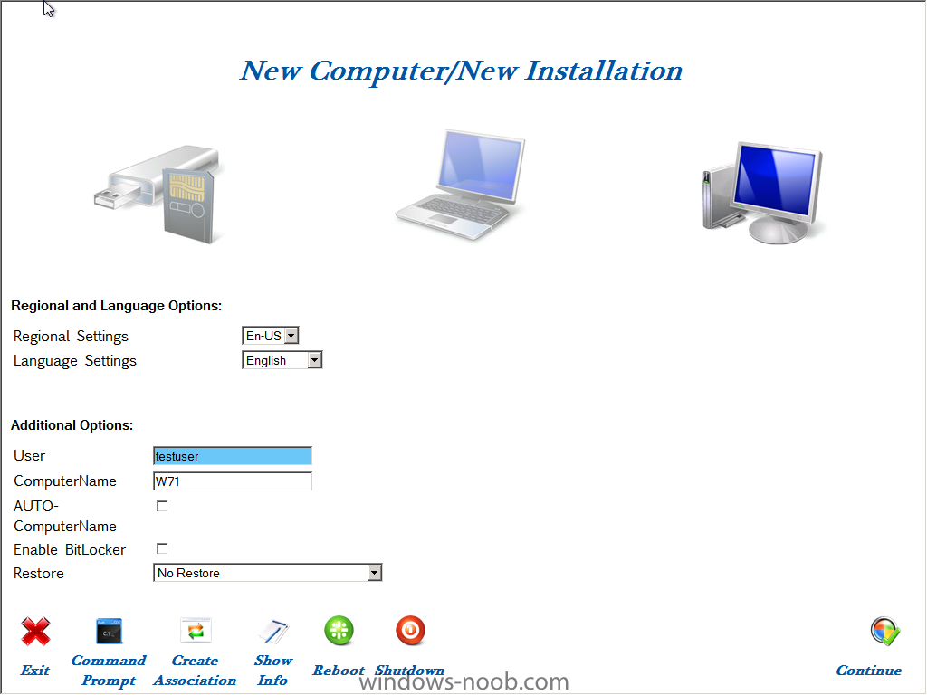

The New Computer Screen with the BitLocker checkbox unchecked

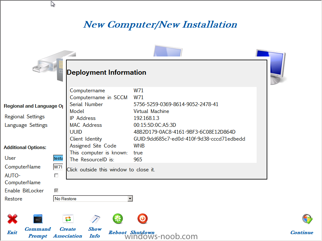

Show Info Screen
Show Info Screen
