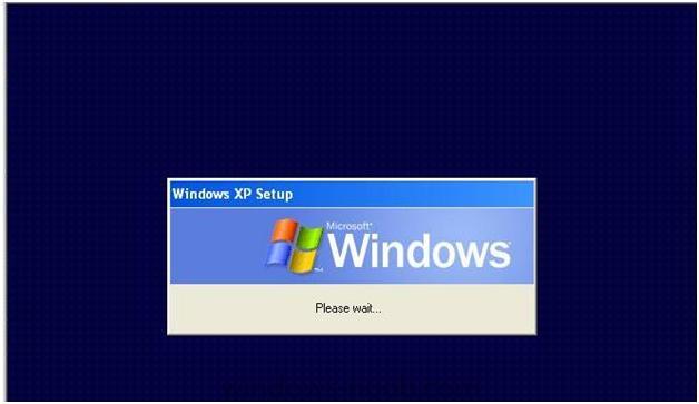

I have a problem with deployent wiht XP OS.
The computer starts the task sequenze and what works, at least before rebooting and installation os Windows XP.
The computer reboots after installing drivers and setup and config, following screen comes up.
but nothing happens. It stays there forever(at least during the weekend).
I`m not able to do a thing and the same happens if I try to restart the machine and even starts over again and run the task sequense.

I'd also suggest comparing the Hardware Abstraction Layer (HAL) on the machine that failed against the ones that worked. If the HALs are different you may need to use a script to change things, or a different image. Remember, XP is HAL dependent (Vista and 7 are not)...
