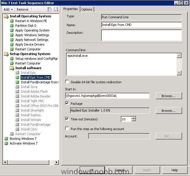

Please See attached image for the fields below
  1. Create the package and program. If you check the box “Allow users to interact with the program”, then the install will happen within a different session number, I’m assuming one of the SMS accounts?<-- correct me if I’m wrong, HOWEVER : you cannot use the program in the “Install Software” step of a TS
  1. Add a “Run Command Line” step and for the “Command Line” field and type in the Program name IE epicinstall.exe.
  2. For the “Start In” field, type in the location of the package
  3. Make sure to Check the “Package” box and select the appropriate package

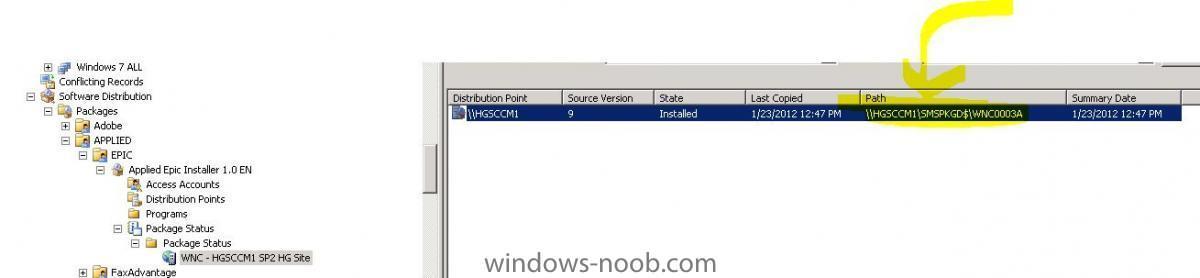

If you dont know how to find out the Package location you can check the package status and it will show the path. see below
And there you go. You can now install an application that has popups or is not completely silent from a TS and not have to rely on logging in after the install and doing it there. I'm still learning a lot about SCCM so please correct me if I've made mistakes on Why this happens.
