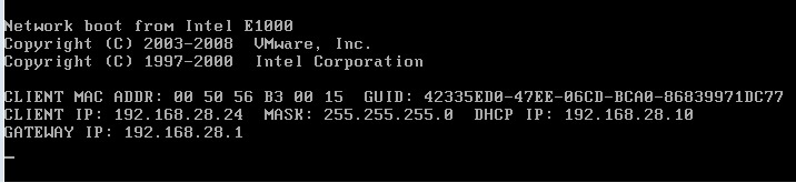

thank you. I deployed my x86 boot image to my distribution point. At this moment, i boot up my win 7 client(vmware guest os). It becomes an ip from the dhcp server, but hangs after the message GATEWAYIP: 192.168.28.1. So the exptected Message "TFTP..." doesn't come up.My win 7 client cannot boot.
On the boot image i checked the option "Distributed image through PXE Service point". With or without this option, it is the same problem as described above.
(In my smsboot\x86\ directory are all needed files available)

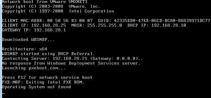

my sccm configured wds automatically. At the moment wds is up and running. But my client doesn't get a answer from my pxe server. See the attached image.
If i shutdown my wds service. i get a message, that the tftp service is not available. But now, i hangs.
I deleted both boot images (x86 and x64). And imported a new image from a win 7 dvd, but only x86.
On my dhcp server as startup file, i configured smsboot\x86\wdsnbp.com. This file is also present in the right directory.
But why hangs my pxe boot?
