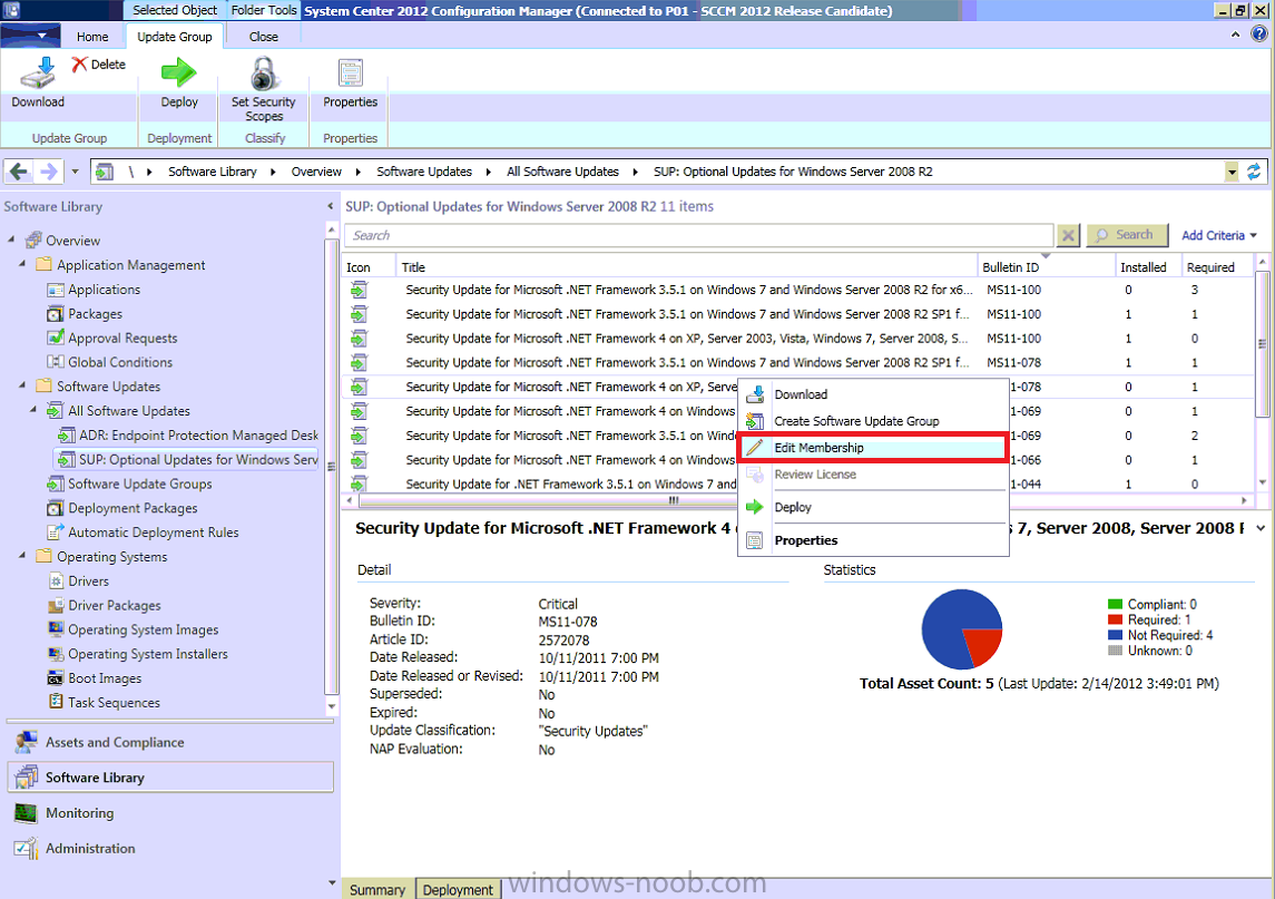

On page 9 of the Lab Part 6 Deploying Software Updates, it is stated: Note: Normally you'd want to look through all these updates and filter out (delete) the ones that are not applicable to you, such as Beta or Service Packs, Delete these from your list before continuing.
However, I can find no way to delete the updates. I do not get that option when I right click on the update nor can it be found on the ribbon. Am I missing something? It would make things so much easier if I could delete the items I don't need. Thank you!
to remove an update or updates from a software Update Group, you need to select your software update group and right click on an update that you want to remove, select Edit Membership

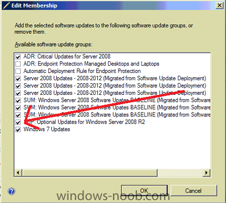

if the update(s) is/are in one or more software update groups then they will be listed here, simply remove the checkmark(s) from the software update group(s) that you want to delete the update from
