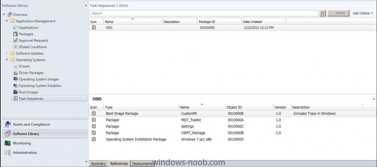

I created an MDT 2012 integrated task sequence, and during the process created the ConfigManager client install package, which i then manually distributed as specified during the wizard.
I'm currently getting the below error in my TS:
The task sequence execution engine failed executing the action (Setup Windows and ConfigMgr) in the group (PostInstall) with the error code 2147942402

Failed to resolve package source "00100002"
Failed to configure OSD setup hook (0x80070002)
Configure hook failed with error code (80070002).
Failed to install setup hook (80070002). The operating system reported error 2147942402: The system cannot find the file specified.
The bold section indicates the package id for the config manger client package, which the ts is clearly looking for, however if i select references for the TS, 00100002 is not shown (see image). Even if i disable the step and create a new step referencing this package, it still doesn't appear in references.

Think I may have been the victim of the issue highlighted in Anyweb's Config guide - part 7 step 5...
"Currently there are two packages for Configuration Manager Client however neither are working in their current form, rather than use them let's create our own."
After creating the client package as described it appears in references, and a capture works fine. will try the MDT task sequence now.
That'll teach me to read the guides properly :)
